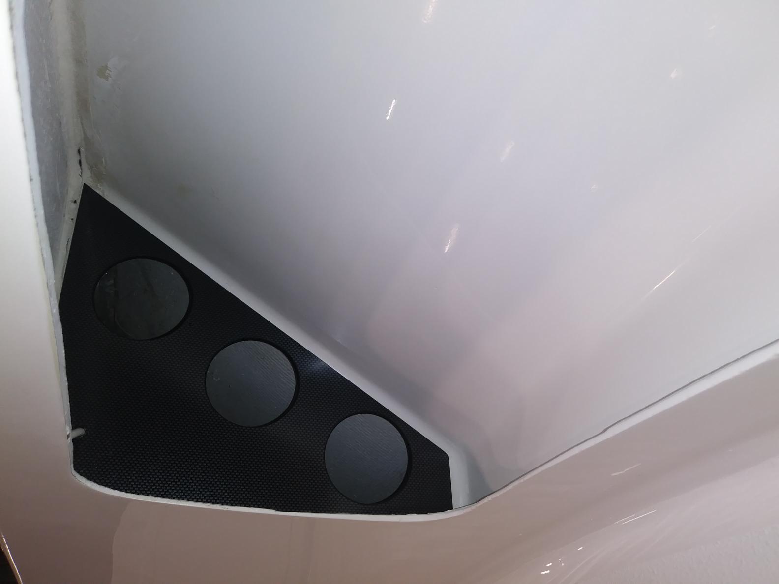

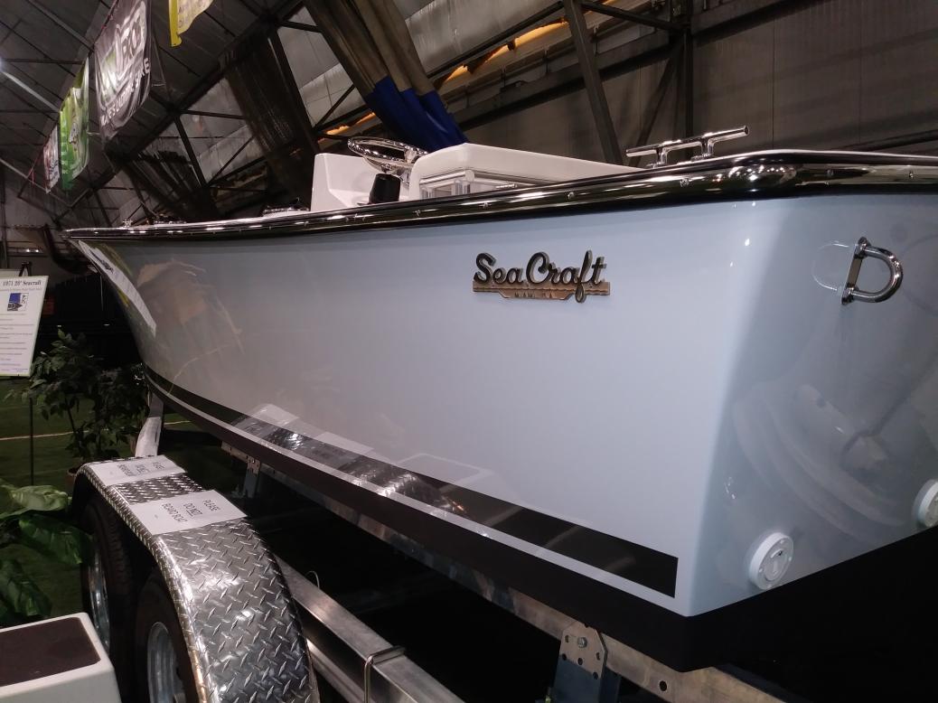

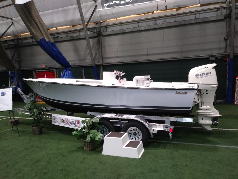

Back in August, a local businessman approached us about restoring a 1971 20' Seacraft that was for sale nearby. Shortly thereafter, he purchased the boat and the restoration began.
8 months later...she is complete. Project list is as follows:
New transom raised to 25 inches
New stern boxes and splashwell
New deck raised 1 inch
Hatches, casting platform and gunwales recored
Original fuel tank in console removed and new 43 gallon aluminum tank installed below deck
New console
New carbon fiber ABS switch panel with Bocatech switches
Carbon fiber ABS accent panels on rod lockers
New Buck Woodcraft anchor locker and console hatches
New Armstrong waterproof bilge hatch
New Gemlux rod holders and hardware
New Rubrail with stainless insert
New Fusion stereo with JBL speakers
New NorthStar AGM battery and Guest charger
All new wiring and plumbing
Decks, gunwales, bilge and anchor locker regelcoated
Hull primed with high build and painted with Awlcraft Whisper Gray and metallic gray bootstripe
New Seacraft emblems
New LoadRite Elite trailer
New Suzuki DF140

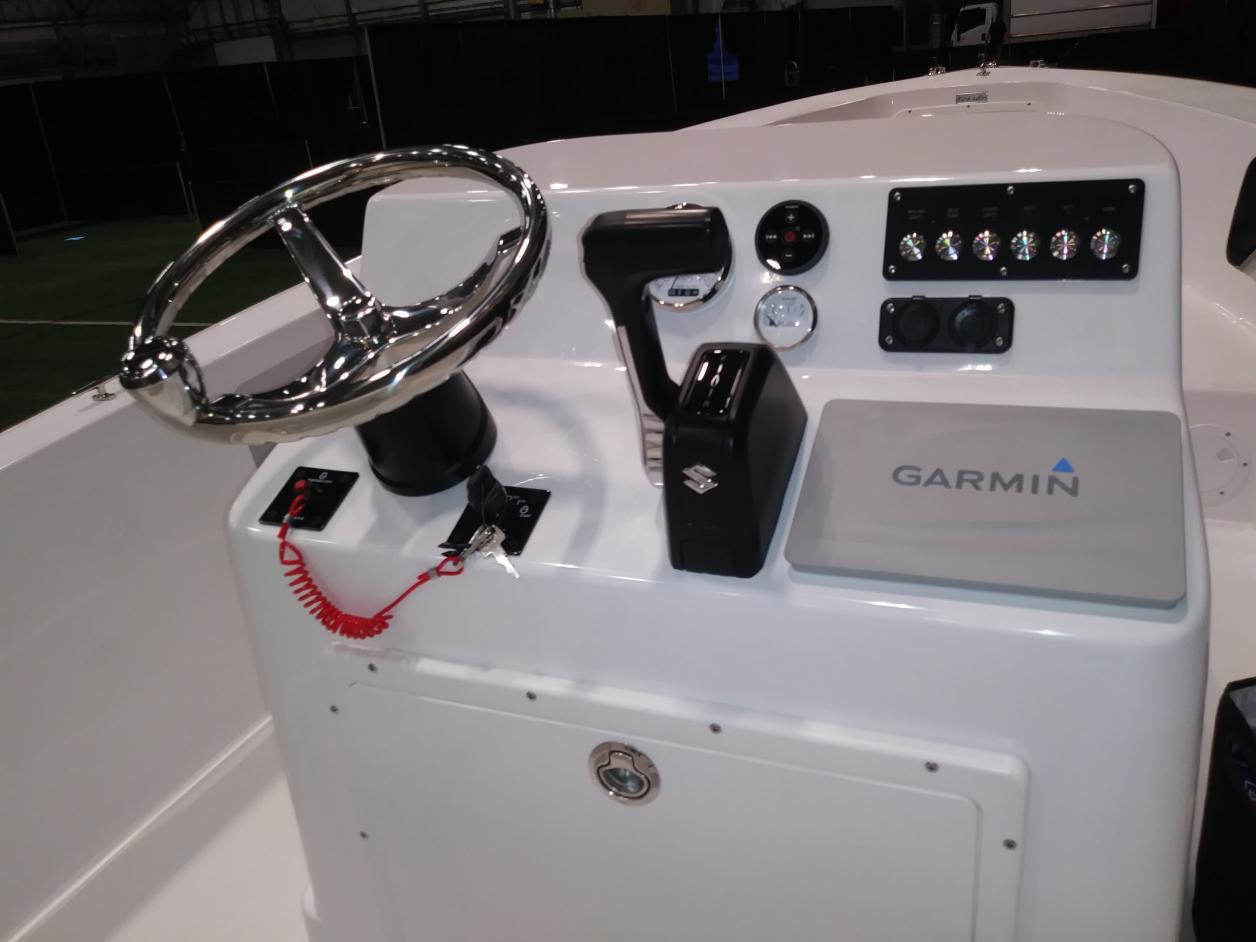

Default Console
Looks great. Is it a self bailing deck that was only raised one inch?
Where did the console come from? Is it narrower then a stock console?
Old 03-25-2019, 10:31 AM
Ed Ed is offline
Location: Boston
Posts: 1,014
Rybones-
We float tested the boat in January after the deck was raised (but before the finish work was done) with the engine installed and with three guys on board. With all of that weight on board the scuppers are still two inches above the water line. We then poured a couple of 5 gallon buckets of water on the deck and the water flowed aft out the scuppers like it should.
The owner bought the console from Marine Connection Liquidators in Ft. Pierce. It only had core material where the binnacle mounts, so we had to core the rest of the console, gelcoat the inside and then gelcoat the outside to match the deck & gunwales.
Lastly, a "coke bottle" green 1/4 inch windscreen with a 7 inch radius on the corners will be arriving to finish off the console.
