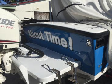

This is what I used on my 73 sf 23

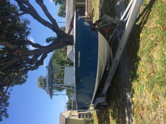

These are the best picture I could find of the corners and bow can try and get better pictures of the bow this weekend
Ok looks good. Are u happy with it.if so I think I will order.thx

That rail detail shows the rubber downturn outboard of the hull. Bushwacker told me that was original in the early Potter hull era, and that that small detail acted as a final spray deflector. Thanks Denny, wish I could remember everything you told me. Haha. Happy travels my friend.
