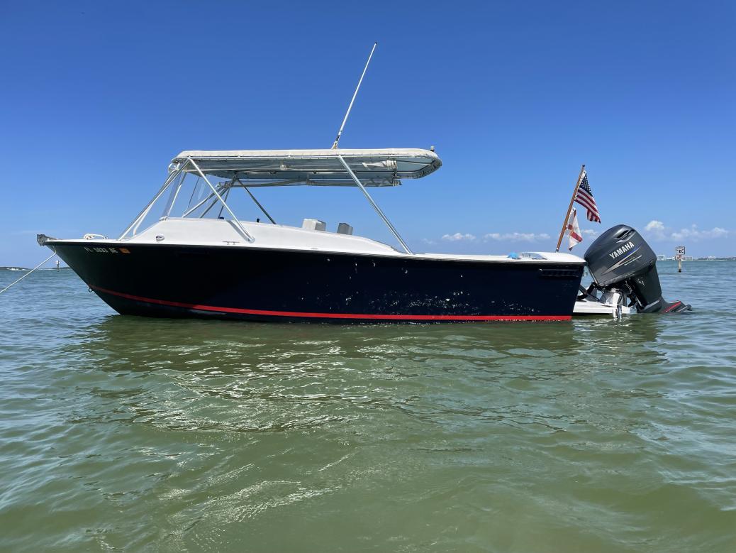

I recently purchased my first Seacraft. Love the boat so far. I was told it started life as a Savage, but was converted to side console by PO. Lady at DMV was confused by last (2) digits being 78 but title saying 79. I told her I assumed 10 meant Oct 78 production. HIN is:
SECG30021078
Can anyone here tell me what does the G stand for? Savage? I've read S meant Savage in other threads. Does this mean this hull was the #002 Savage for 1979? Or the #002 23' of any configuration for 1979? It makes sense that 10/78 would be early on in the production run.
Thanks for any help.

SEC - SeaCraft
G - not sure but if S was used for Sceptre, perhaps they used G for Savage
3 - 23 feet
002 - hull #2
10 - October
78 - 1978
Considering the Savage was quite rare, I suspect that is what you're boat started life as since it's hull #2 so late in the year. However, that top cap in your photo is not from a Savage; original Savages used the Sceptre cap and removed the windshield. Nice looking boat regardless.

SEC = SeaCraft
G = Savage
3 = 23'
002 = Hull #2
10 = October
78 = 1978
after Aug titled 1979
Scott is Correct. Looking at the cap it apears to be off a Sceptre or custom molded? Many modifications can change shearlines appearance over the years. Maybe you can trace back previous owners to get its history.

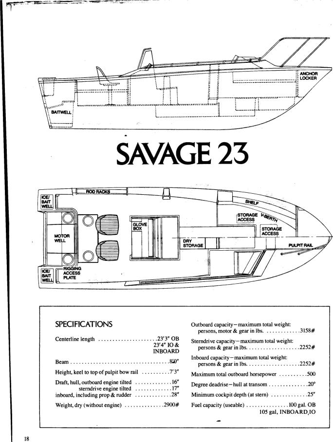

Here is a pic of a Savage.

Thank you for the responses. I had read elsewhere that Savages were denoted by a S, hence the confusion.
Yes, the PO told me it was a Savage (CC w/ cabin) and that he did quite a few mods, including the height and shape of the gunnels. I was trying to confirm. It looks like a mini sport fisherman/express to me. May not be for purists, but I really like it so far. Large amount of open deck space compared to CC/Savage.
So it would be #002 Savage for 1979? Is there a Classic Seacraft Registry that I haven't found yet? I'm into old Whalers too, and have my 1973 Mountauk on their Registry, and its kind of fun to rebuild the history and lineage of our toys.

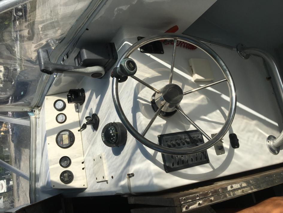

Any idea if the pics (vs. the drawings) of the Savage you posted show an original cabin top w/o glovebox? Or has that one also been modified to be flat top?

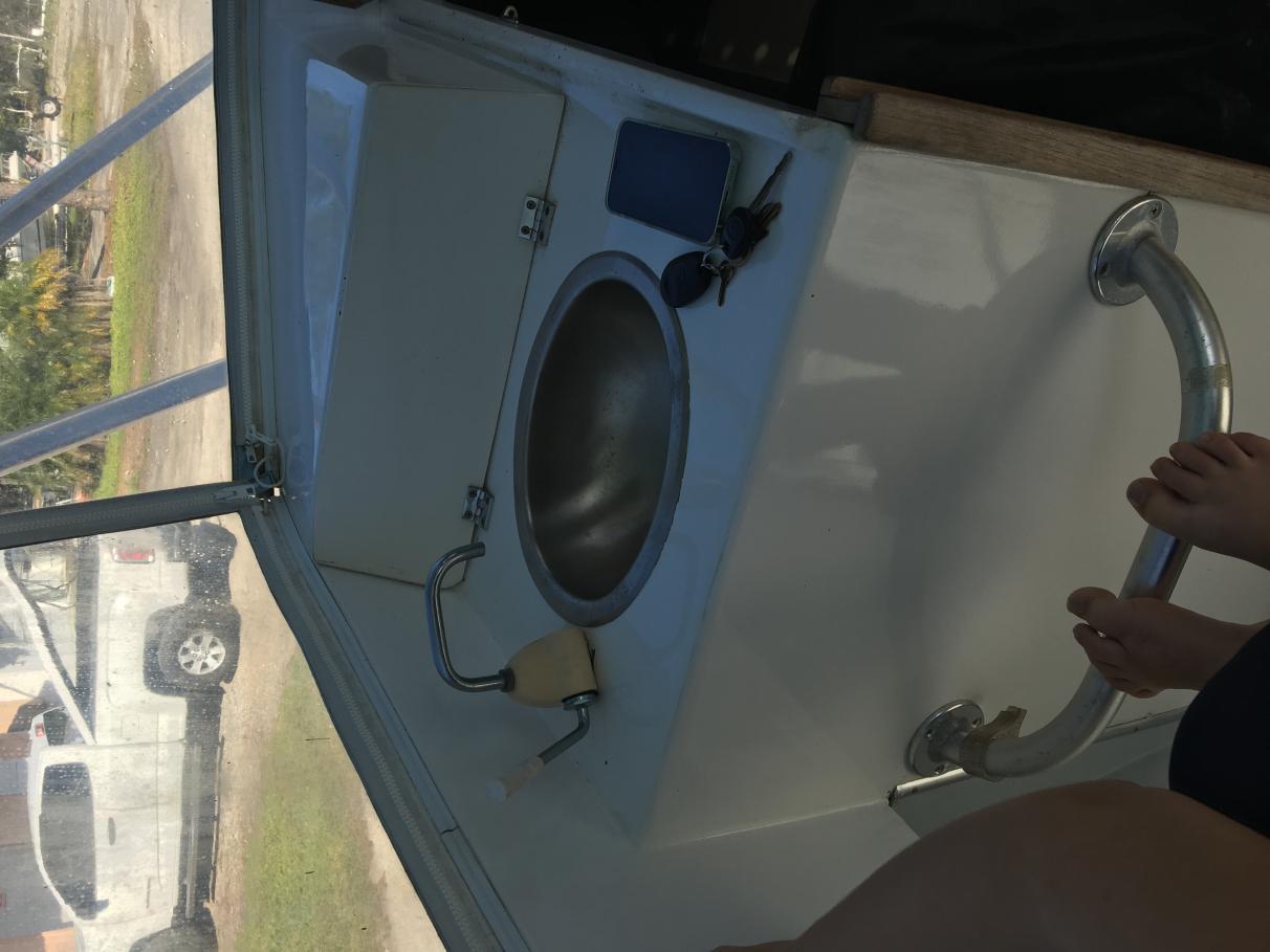

Mine still has the glovebox to Port and the instrument gauge to SB in the factory locations (for a Scepter).
