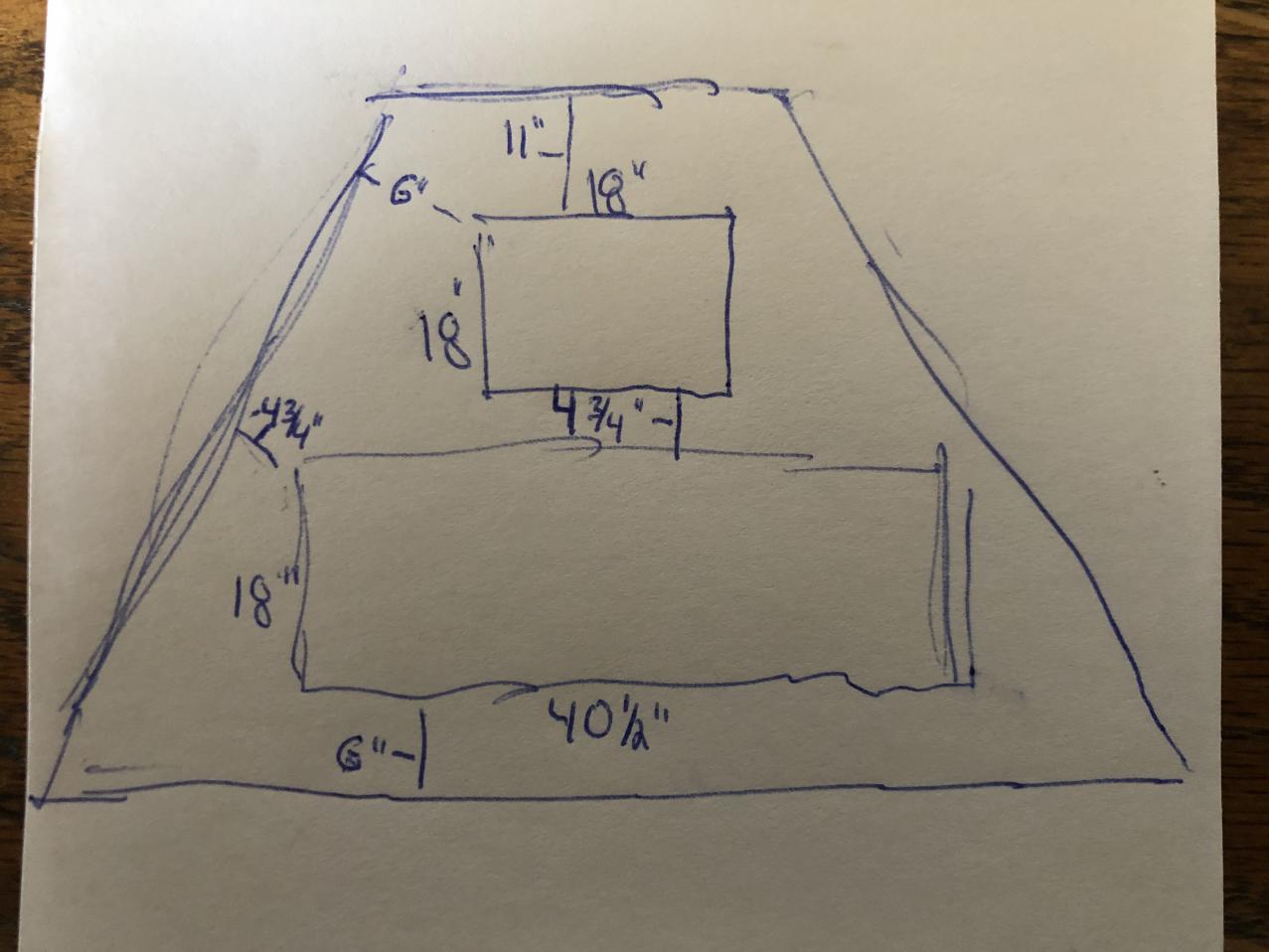

Somehow I found the original hatch for the front compartment in the boat, but I would like to get the dimensions of where everything goes because I'll be making a new floor up there. I need the size of the fishbox hatch and where it goes in relation to the front hatch.

These are the dimensions of the front deck of my 1975 20' SF.
