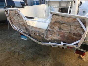

I only saw 1 pic on that link, can ya take some more?? |

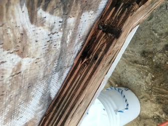

These are the only ones on my phone, I can snap more when I?m home. I really screwed my self by not leaving a lip for the scarf, I really just attacked the transom without thinking of leaving more room until I stepped back to look at it lol.
The plywood there is a sample of what came out. The new transom will be composite either pourable or coosa. |

The problem now is tying the outer skin back into the hull. Without a total deconstruction of the inner skin youre kinda stuck with beveling and tabbing the outer skin to the outside of the hull. If youre doing that, the thickness doesnt have to fit back into what was originally there, you can build it to whatever you wanted.
So use two at 3/4 destroy whatever lip I have remaining on the outside and wrap around to the hull sides? I’m ok with that as I was thinking of painting the hull in the future anyway, and it will allow me to get a 12:1 scarf. I think I have to wrap to the hillsides anyway I really screwed that one up! So many ways to skin this cat.
