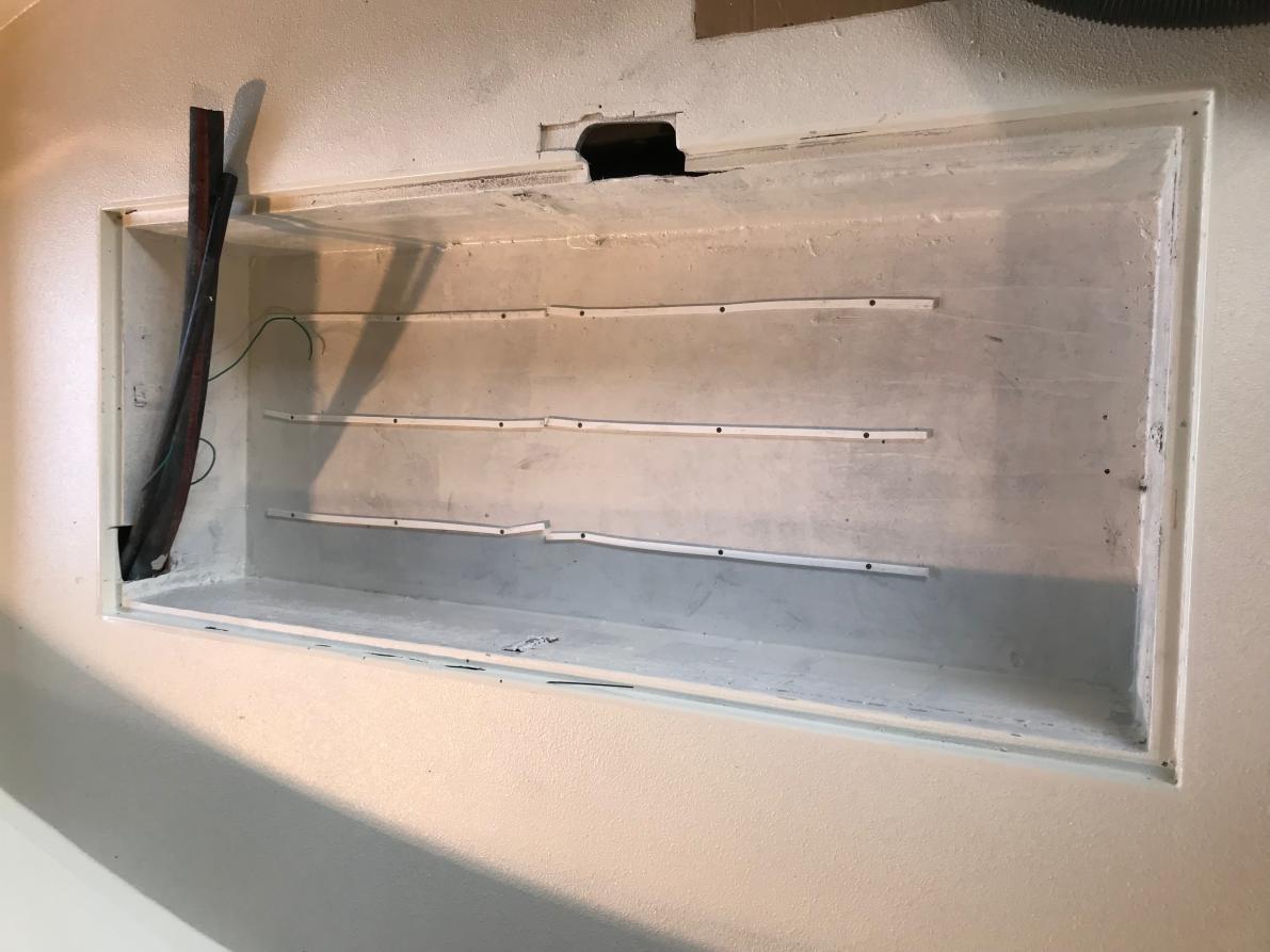

I didn't use anything. I laid some 3/8" wide starboard strips down and installed the tank. Except for where the strips contact the tank, air can get around the rest of it. It will outlast me! BTW, when I replaced the floor, I moved the console forward so if the tank ever has to be removed, the console won't have to come out.

Umm - so bare alum? Did you glue the strips to the floor or the tank? The other tanks I've done I coated with coal tar epoxy, then glued the strips to the tank. I would think gluing the strips to the floor/stringers with a bare tank might possibly let water in between. Over-thinking this?

I screwed them down. Got heavy with a couple screws, but it works.
http://www.classicseacraft.com/commu...1&d=1602538183
