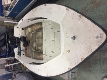

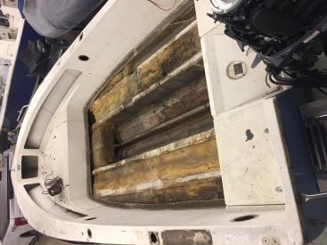

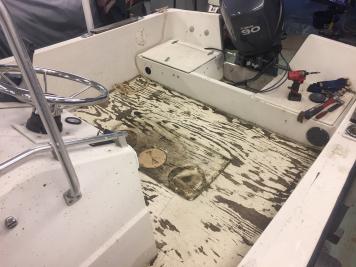

Here are a couple photos of the boat from the other day.
