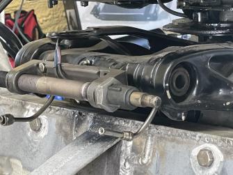

Moose - I run a seastar 1.7 helm with a hynautic k6 ram (you just have to change to seastar fittings). It'll work great for that motor. Let me run down to the garage and I can get numbers of the older seastar stuff. I also have Shana's seafari here with that exact mid section and he runs a baystar setup.
Serial number is 1984 mercury 2.4L 200hp. You have a single ram mid section with external trim and tilt. The 1pc. heads are newer from 88/89/90.

Old 08-26-2021, 08:44 PM
Bay Star Ram (shana's)
Old 08-26-2021, 08:46 PM
Hynautic k6
Old 08-26-2021, 09:46 PM
current seastar offering
Old 08-26-2021, 09:56 PM
Old discontinued seastar ram HC5340-42
Old 08-26-2021, 10:00 PM
Old discontinued seastar ram HC5340-42. I haven't used one of these recently on an older 2.4L 200, but I don't recall having any trouble with it.
Old 08-26-2021, 10:02 PM
The 1.7cu seastar helm, 2 hoses (seastar) and the hydraulic ram is all you need.

Thank you for the detailed assistance and photos! We where thinking a bay star would work but he wants a faster turn response than a 1.7 so we’ll have to work thru that.
