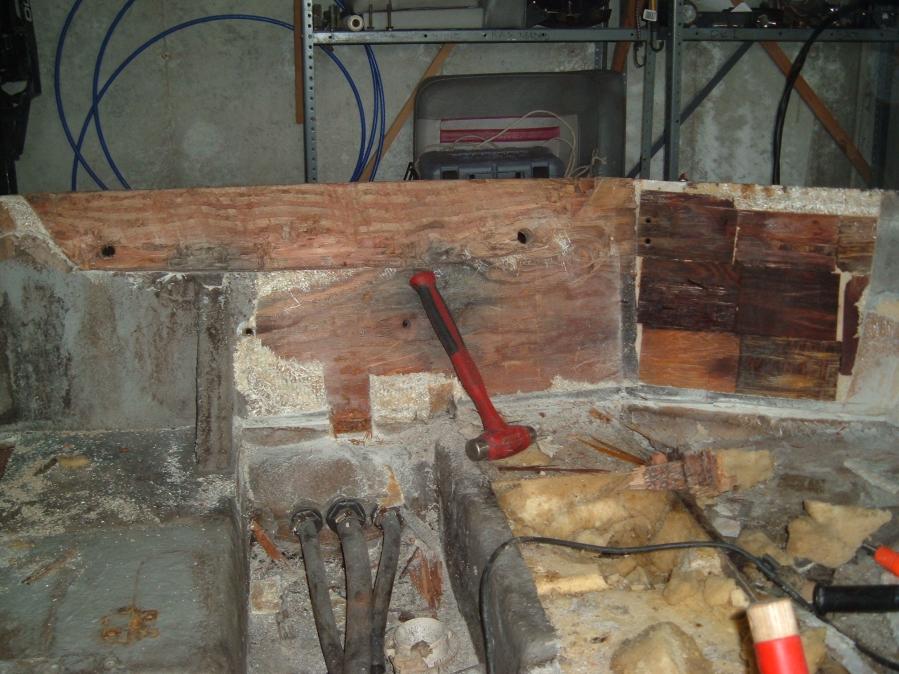

This is an old tracker bass boat I restored where they did just that. Seemed fine. Just odd.
