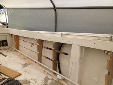

Found this picture of the access hatch I made to help getting the 1 1/2” hose in . I also put a couple layers of wax paper into the 90 degree area to help the hose slide around the inside curve. Soap and all can help but can also make it hard to pull or push as well
