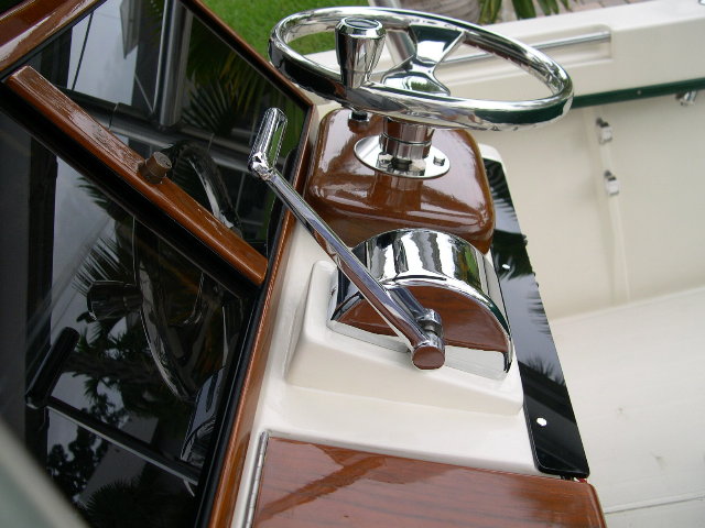

Old 03-01-2016, 09:07 AM
I must be missing something here on your gunwhale config.
The wedge would be held in place with the rod holder bolts thru to your backing plates. I had to do the same for my throttle controls. See pic

I get it now. Thanks for the pic, Chuck. Your setup looks SWEET!
