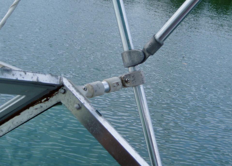

Even though I'm in my 70's, and not particularly well coordinated, I've found that bow accessibility on the Seafari is not that big a deal, especially after I figured out how to brace the Bimini top off the windshield (see first pic below) to make a firm handhold for going around the side deck. (I hope your VHF antenna is mounted on port side so it doesn't get in the way!) Don't remember if your boat has a bow rail on it; the bow rail sort of gets in the way, but I like having it in rough seas, as it's kept me from going overboard many times! Or as Connor says, just go thru the cabin hatch. You also don't need a windlass or a bow pulpit if you have someone with you (an anchor wench?!) Although I can see where you might want a windlass if you plan to go out by yourself a lot.

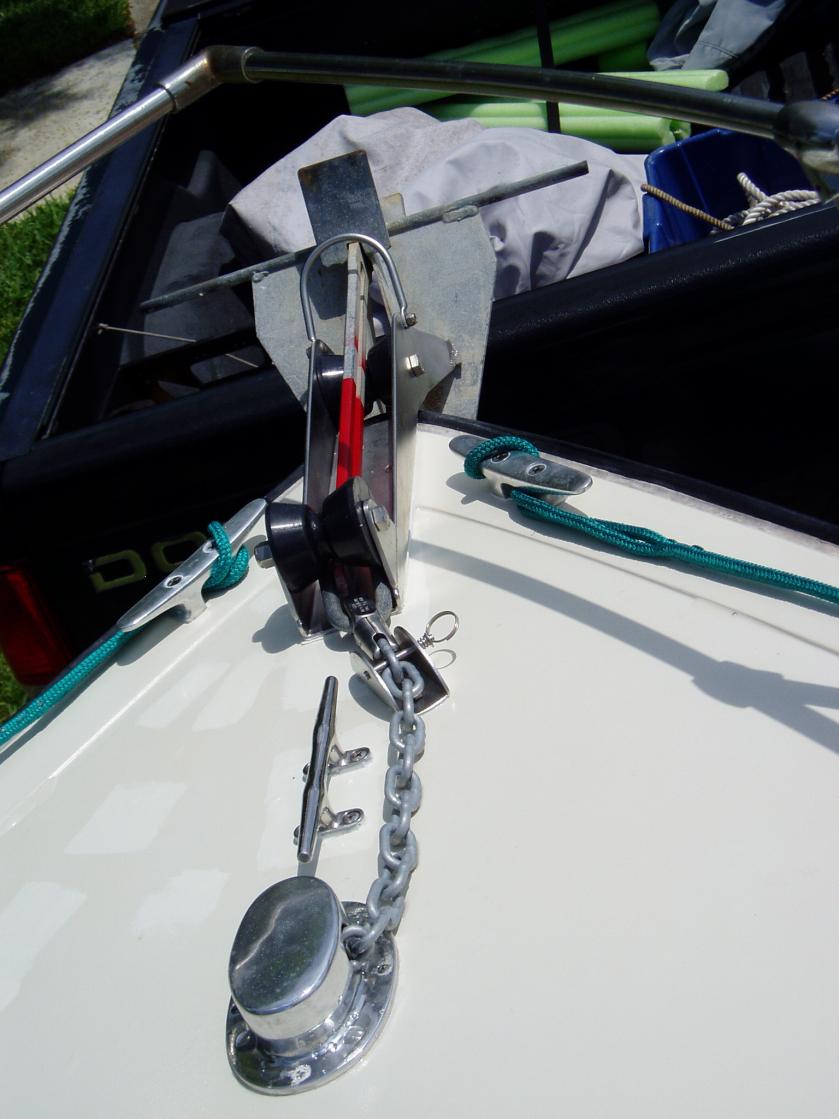

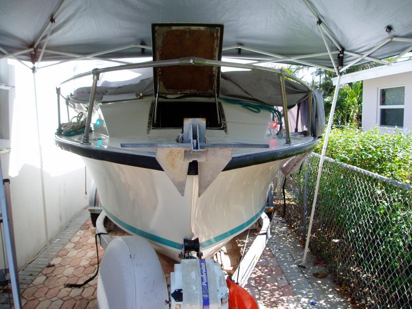

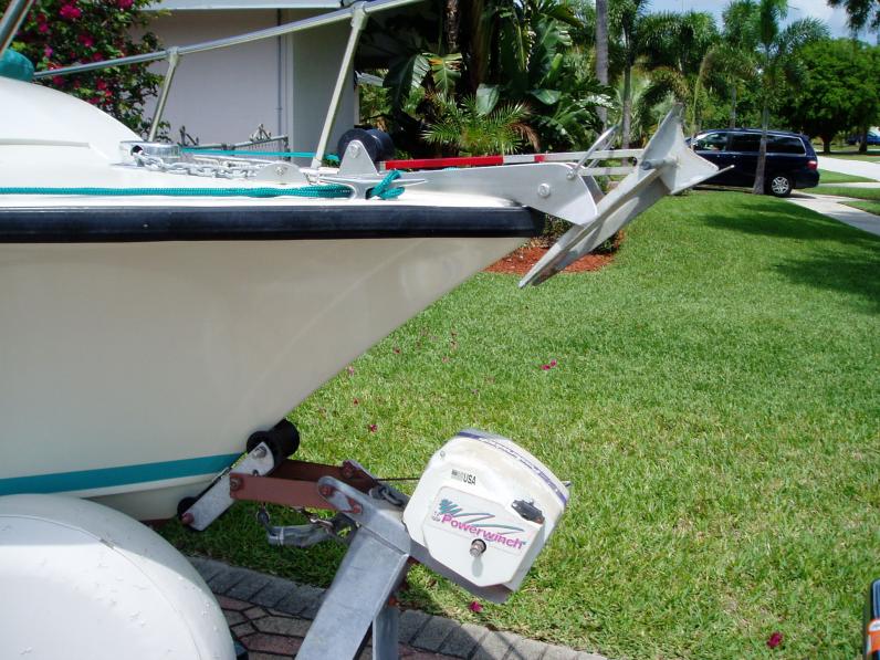

What you need is a big oval deck pipe centered over the anchor locker, a center cleat and a roller bracket for the anchor. (I carry 300' of anchor line and 20' of chain; if you don't center the deck pipe, the line will pile up on the flare of the hull when you retrieve it!) I did a post of my anchor bracket install about 6 years ago but can't seem to find it, so I'll post some of the pictures here. My bracket doesn't hang out over the bow very far, but it's not hard to pull up the anchor without hitting the boat if you're carefull. When I'm in the keys for mini-season, I probably drop the anchor at least a dozen times/day, often trying to anchor within a few feet of a waypoint so I can use the scuba/hooka rig right from the boat without having to put the tank in an inner tube. My setup works very well, although I've found that GFS makes a real handy anchor wench, so that helps too!

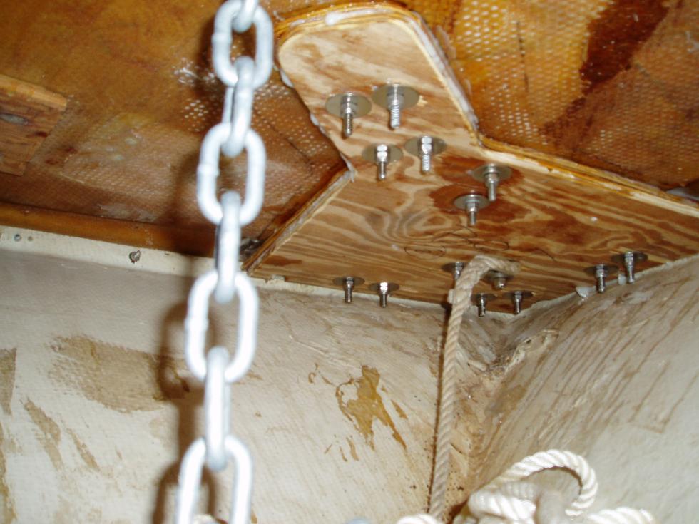

That roller bracket creates leverage that can put some serious loads into the deck, so I felt it was important to beef up the deck. I believe I used 2 pieces of 3/8 plywood, coated with epoxy and bonded to the underside of the deck with cabosil. I used 2 layers of thinner plywood so it would conform to the deck curvature and supported it from underneath with a bottle jack till the epoxy cured. I also used some 1/2" plywood backing blocks under the 2 OEM bow cleats, which fit into the raised "toe rail" section under the cleats, which made it flush with the rest of the deck so the big 3/8" panels would fit smoothly over it. Denny

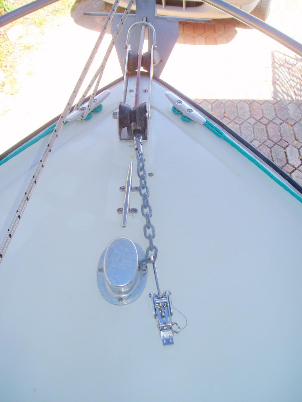

The original anchor lock was through the reinforced part of the deck (see pic below) but it was just a pin thru a chain link and didn't keep tension on the chain, so I had to use a bungee cord on anchor to keep it from rattling! The current lock I showed previously is adjustable and puts just enough tension on chain to keep everything from rattling but there isn't much load on it, so no reinforcement below it, except for fender washers. I also rotated that center cleat 90 deg; have to run the chain over the SS cleat now, which doesn't hurt cleat but it provides much more clearance to wrap lines on it. Original configuration in pictures was a little too close to deck pipe.
