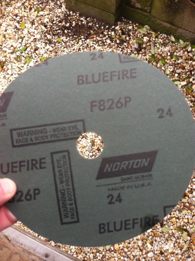

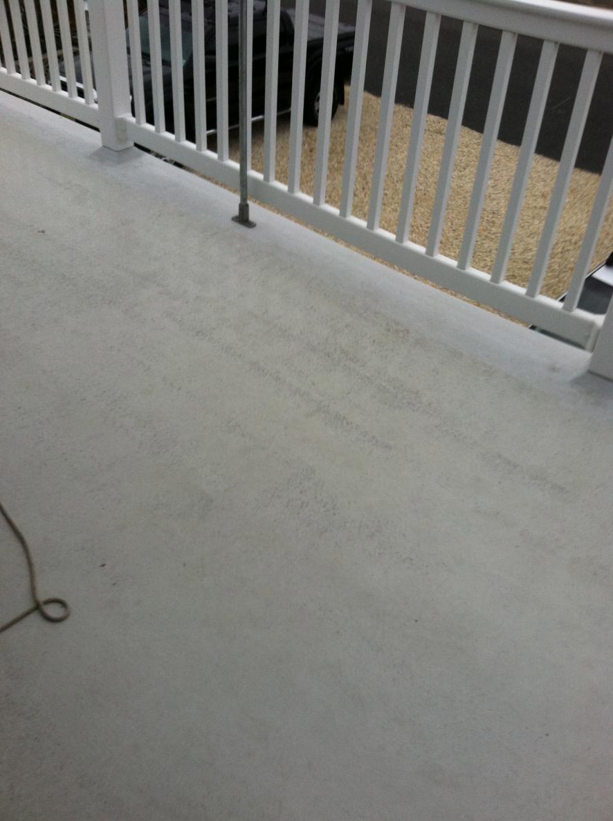

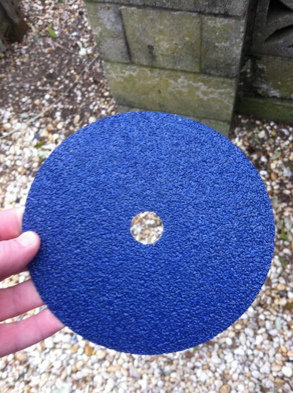

Here on the beach in NJ we have fiberglass decks and roofs and over time, usually 12+ year they will require a "recolor" with is basically grinding off the gelcoat and reapplying. We use 24 grit sanding discs on a grinder with a plastic backing pad. Ill try to attach photos.

As well they make them in 40 grit for less aggressive applications. The photo of that deck is after 18 years, thats why its not very clean looking

that blue paper is pretty good, not sure what it is , but works good and last longer

Default Disk
A pic of the backside would be nice..there's alum oxide,ceramic. And silicone carbide..but what is best, I guess I will have to try them all

Posts: 321
I think 3M makes these as well, they do a great job removing but if you use them be careful and don't stop moving the grinder. It can't damage fast!
