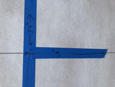

I want to install electric trim tabs . Have built a 30 inch Armstrong for a 300 Yamaha and will this week draw out on Transom the location it will sit to check trim tab clearance .does anyone have this setup with recommendations on there tabs will help me to move on. Thx

Thx the bolts look good. Based on the Armstrong spec measuring up 28 inch 72 inch wide and back down 2 inch for bracket it looks like I have a little more than 12 inch to work with so they would have plenty of room. That is mounting past last chime all the way outside. About 3 inch from outside
