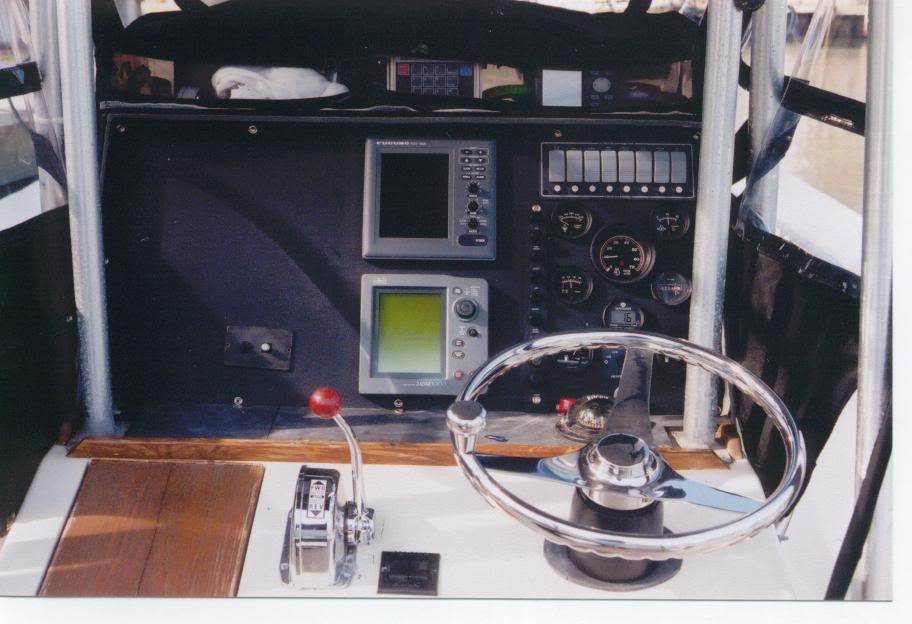

I am in the process of rebuilding my dash board area on my 1974 Tsunami- I am going to use black plexi-glass to flush mount my electronics, gauges, etc. I was wondering if anyone has any ideas on how thick the plexiglass should be? Or if anyone has used any othe material to do this modification- any pics are appreciated also. Thanks

If I remember correctly Lexan is much better than plexiglass stronger, not brittle, wound crack, and holds up better. If you do a web search you will learn more that you want to know.

i used starboard for mine- the 3/8" was a little flimsey for me , i ended up using 1/2" . Plexiglass is a pain in the ass and will crack like a son of a beech if you aint real careful. The starboard cleans up real nice when wiped down with woody wax occasionally too. these pix are a few years old now and its changed somewhat now but you get the idea- (unless you dont like black)

If you use Plexi, make sure you back it with a piece of wood before drilling any holes. This will prevent cracking. I used PVC Board and then painted. It cuts, molds and sands like wood

PLEXIGLAS IS NOT A GOOD IDEA. UV AND COMPRESSIVE FORCES WILL CAUSE WHAT IS CALLED CRAZING. (SMALL CRACKS RADIATING FROM THE CENTER OF THE HOLE)
STARBOARD A BETTER OPTION.

Mine was redone with starboard, very easy to work with.

Made a mold of the old wood/teak dash.Glassed it. I was worried about leakage around the gauges-radio-electronics as I didn't know anything would seal it(Starboard).
