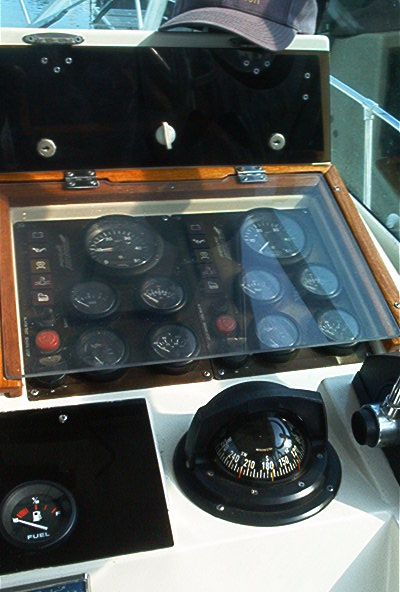

Here's some more stats on Cummins Merc diesels.
My 25 Grady Sailfish was originally powered with Mercruiser 470 I/O's. She cruised at 18 knots at 3200 RPM buring arounnd 12-14 GPH. Top speed was about 31 knots.
I repowered with Cummins Mercruiser 1.7 DTI Stern Drives and my cruise went up to about 20-21.5 knots at 3300 RPM.(I can cruise faster if I wanted to) At this speed I burn 5-7 GPH Combined. Wideopen throttles I run 4400 RPM at top out at the same speed as before, 30-31 knots.
My fuel efficiency doubled while giving a higher cruise speed.
Instruments 1
