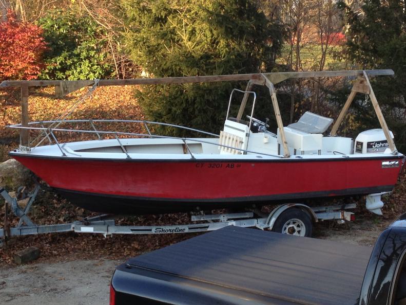

And how she sits today.
My 1973 SeaCraft 20SF

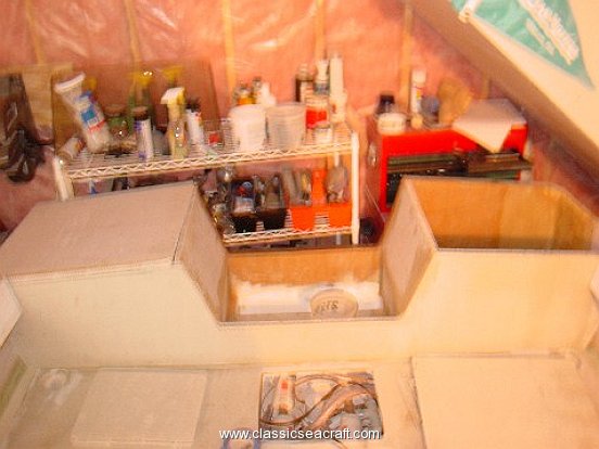

I found this pic going through the archives. Anyone have experience with fitting a livewell in front of the console in the stock seat??
I like this concept, not to impressed with the install.
