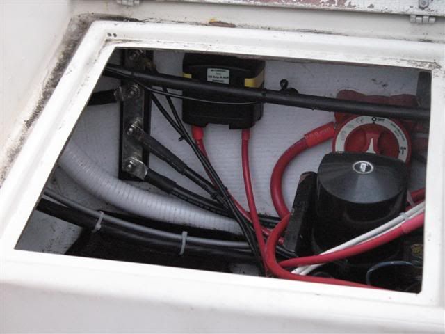

Pic is the switcher and relay in strbd locker, along with a neg bus bar which helped clean things up. The cranking battery is removed. I have a mercruiser I/O. I found the best deal on cables from an online place genuinedealz.com, which despite the cheesy name has good prices and you can order custom length/size cables with the lugs and heat shrink done, quality of work is very good.

Thanks for the input, Guys. Nice looking starboard locker, rhody. I'd love to see the arrangement on port side. That is the Blue Seas system I had in mind, Right now that ACR wouldn't even fit in my stern s/b locker. 2 batteries (deep cycle appears to be shot), h2o/fuel separator, bat switch, bait pump switch, trim/tilt motor, bilge hose, and all cables are filling the box. There's so much going on there it might belong in the hall of shame. Moving the house battery over to port stern is feasible but there is a live-well set up in there. Gotta figure out how to safely seal it and create a platform/box for battery.

Maybe a silly question, but how do you attach bus bars and switches etc., just screw into transom?

The port side is empty except for the cables waiting for me to install the battery box. There was a lift out ice box there. To install I used a sealant in the smaller screw holes and for the battery box tie downs I drilled over size holes, filled with epoxy and redrilled for the screws.
Not sure how you solve your undercharging problem with a new battery, it also needs to be charged. My mercruiser puts out plenty of juice to charge but in thinking about your situation, I believe the relay controls the charging in way that focuses on the cranking battery - and w/o the "2" switch I dont think you can just send the charge to the house battery alone. I would actually contact Blue Seas and discuss your issue w/9 amps - I have called and emailed them in the past and found them very responsive....I'm no electrical genius either.
