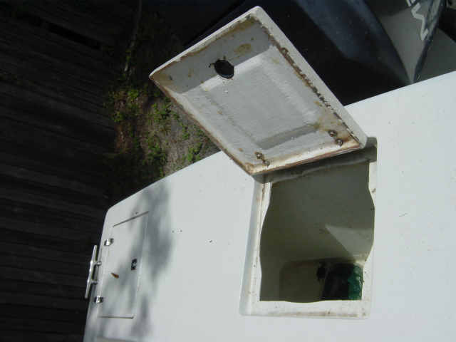

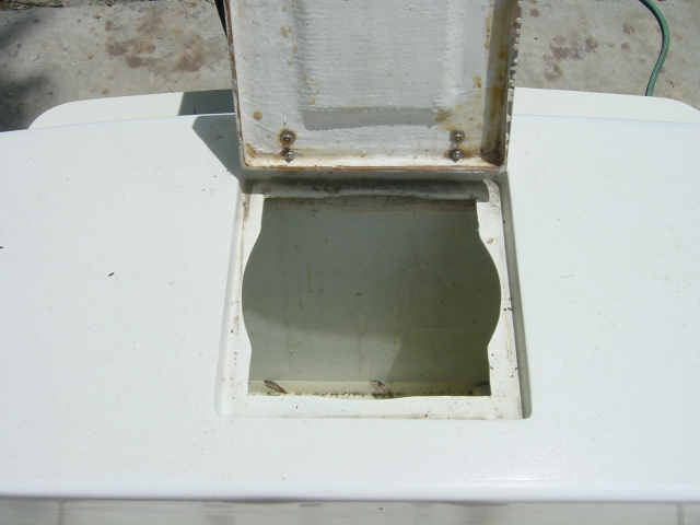

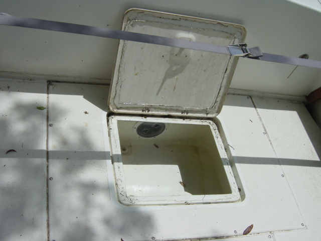

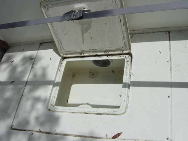

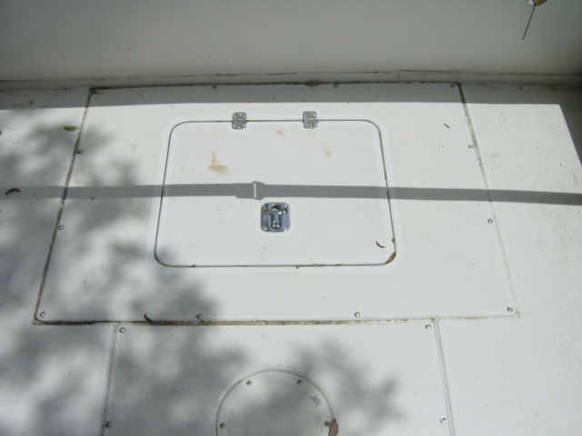

These are shots of my in-floor fishbox.
It is a little squarer than most, but I can tell you that a 30 pound grouper will fit in it. I carry one of the high tech chill bags in the cabin and if we get a big dolphin or Wahoo, just transfer the ice out of this, into the bag, slide the fish in, and toss it on the floor of the cabin.
This box has 2" of insulation all around, and the lid has a lip with water drain, and seal. It holds ice for a couple of days.

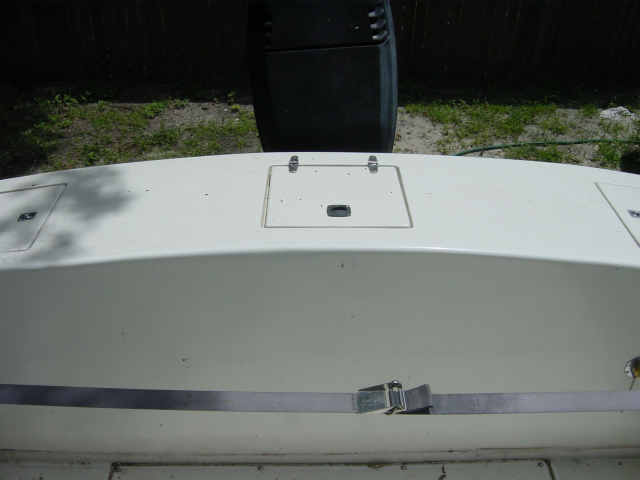

These are shots of my in transom livewell, all 42 Gals
If you have any questions, let me know.

Thanks for the pics! That gives me some good ideas for getting this project started, but probably not until fishing season is over for the year.
One question, I noticed the screws running around the deck where the hold appears to be. Did you just cut up the deck and then replace the same piece by screwing it back down after the hold was installed? That seems like it would save a lot of work.

This is a 23' Sceptre, 89 version, and the deck was sectioned up already, with screws holding it in. It used to have the livewell in the floor, I moved that to the transom, and enlarged the livewell tub, insulated it, and put a bigger hatch on it.
