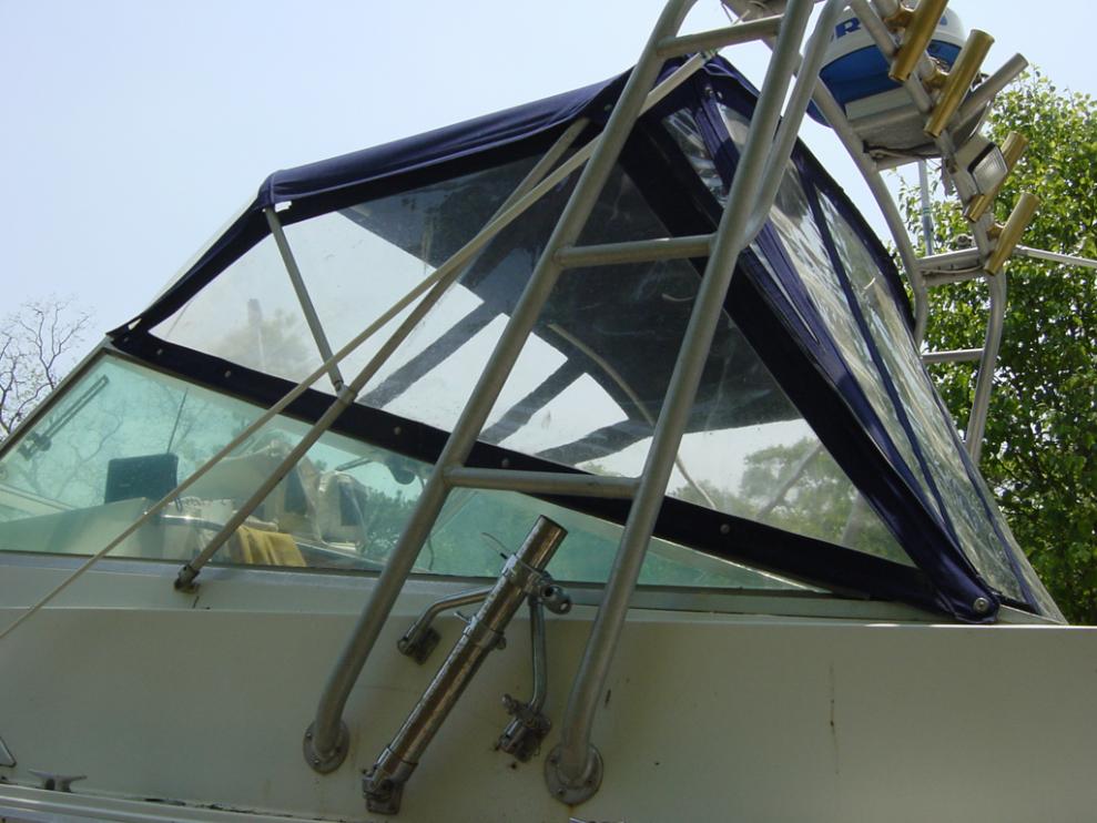

Scraping the teak and maybe replacing canvas is next. I only got half the parts with the boat- I want to get back to the image below. Or a hardtop.
