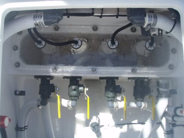

Thanks in advance for any advice you can give. I am going to atach an image of the sea chest in case someone is unsure as to what I am talking about.

Whats all that for? What does it accomplish? Sprainer for raw water cooled engine(s)? and bait/live wells? How do you clean it out? I'm confused, looks like a lot of work and valves, etc.

Basically it keeps the livewell pumps which are bilge pumps in this application from air locking. when the pump is mounted directly on top of the through hull like mine are now the smallest amount of air causes the impeller to cavitate. With the sea chest the pumps are always submerged in water preventing an air lock.
The plexi lid is removable if you need to clean it out but I have gemlux high speed pickup which should prevent any grass from getting into the chest. The plumbing is rather involved but I think it will be worth it. Right now my pumps air lock anytime I back down hard or I come off plane which is a big pita.
This design was pioneered by Fred Herman from what I understand and is commonplace on the south florida sailfish circuit where they carry hundreds of gallons of live bait.
Many builders such as conch, contender, invincible, weaver, sea vee and others use the sea chest to supply raw water.

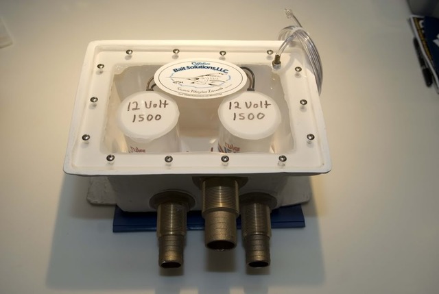

Do ya'll think the laminate will be strong enough with the four layers of 1708 and and two layers of 1.5oz mat? My calculations show the final thickness will be about just over a quarter inch plus gelcoat (0.266")
If it's not any bigger than the one in the picture, 1/4" of laminate is overkill. You can get away with 1/8" if you make the high stress areas (where fasteners and seacocks mount) thicker. That assumes the tub will be well supported once it's installed.
I would core the area where the seacocks are going. That will stiffen it up and provide backing for fasteners.

Blue Heron, Thanks for the advice. I had considered using a core material and still may on the bottom where the pumps will be screwed down. One reason I thought going with a thicker laminate all the way around is because the chest will have plumbing or screws on every side. Also the box will not be supported underneath. It will be resting over the keel and fastened to the hull on the sides with wings like the chest pictured below has.
