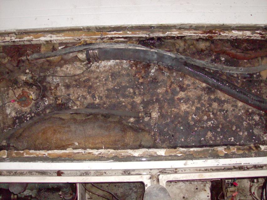

take a look at this picture,zoom in on the sender - pay attention to the screws - they're not the same all the way around - you should notice that...the owner of this boat,he did a similar thing as you're going to attempt.stripped threads,used a big self tapping screw-end result - take a look at the top of the tank,clearly it's "stained" around the sender - clearly leaking...
there's another way,to attempt repair - provided the tank's in good condition - if the threads pulled,odds are the tank's pretty old ...it appears you've had some problems with your fuel system...
