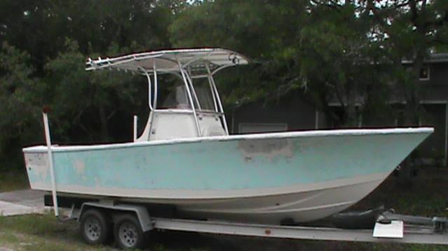

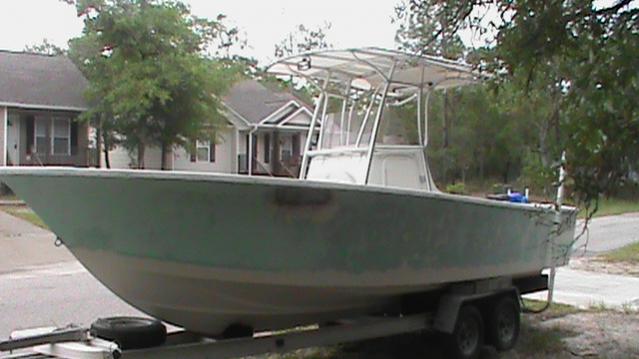

Hello these 23' was completely redone less than 3 yrs ago, she is now back under the knife for some well deserved upgrades, fist of her transom was closed in a few weeks ago, she will be getting new power from a hpdi that is new, i have had this motor sitting on the stand for a year now waiting to figure our what i wanted to do with it.. she will be getting all new hardware from the ground up, just to name a few, stainless Southco compression latches, southco pop-up cleats, taco rigid rub rail with stainless insert, Volvo penta trim tabs, new custom built leaning post with 45 gal livewell,sea star tilt helm, new sea star hoses and hydo steering cylinder, all new shurflo pumps and hose, I know you guys love pictures as much as i do, i restore boats for a living so i find myself to busy to snap pictures, i will try to start taking pictures each day so i can post for the folks who have a special love for seacrafts as i do. i also would love some input on hull color, i have a few in mind like... lime green, black, mint shake and tropical lagoon. i will post a few pictures tonight of the hull and livewell mold thanks for looking.

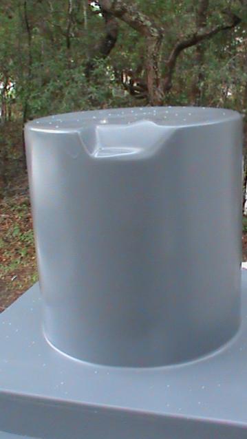

Here is a few pictures of the hull sanded ready for primer, and a picture of the livewell mold ready to be sanded with 600/1200 then be buffed out. livewell molded was built using 3/4 mdf glassed and then shot with 10 coats of duratec vinyl ester primer, for those of you who have never used this primer it is used for resurfacing molds really a great forgiving product, primer was shot using a G200-6 Gel Coat & Resin External Mix Cup Gun, for those of you looking for a livewell I will be pulling a few parts from this mold next week, the leaining post mold is almost complete and I should have pictures up next week, Thanks for looking

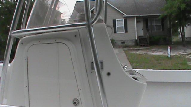

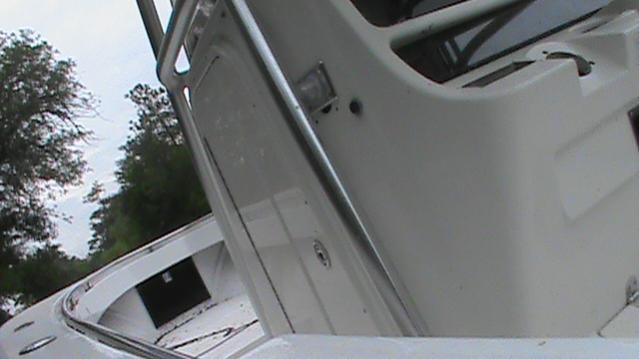

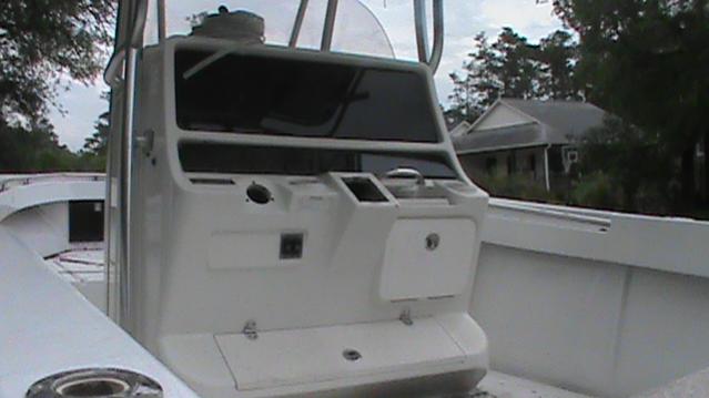

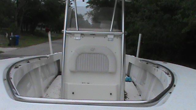

A few more pictures of the console

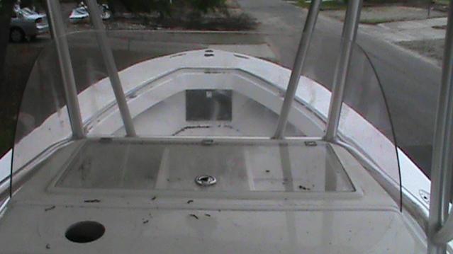

top of console

Will you be putting the hull vents back?
No I glassed them up to give the hull a cleaner modern look, I like the vents but i seam to like the clean slick look better..

I Laid up a few of these if anyone is interested..hand laid 1708 the leaning post plug is almost done will take pictures soon

where did that console come from i like the set up. can you show some pics with the side door open
I will take a few Sunday and post them, The console come out of a 29' seafox, are you looking a console? I have a new one that is very nice
