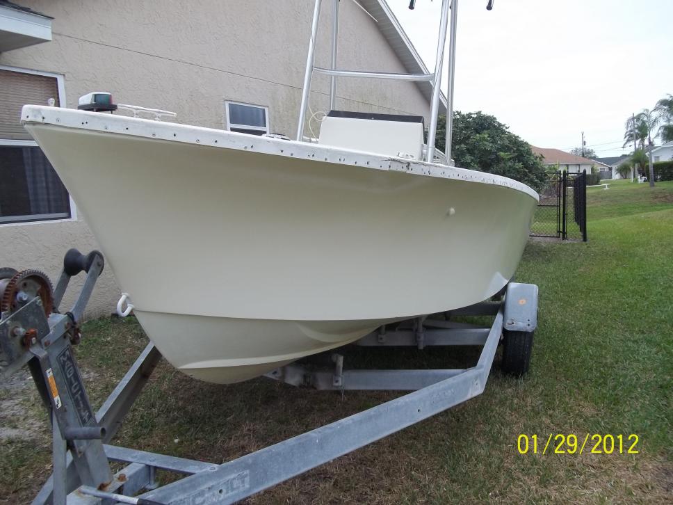

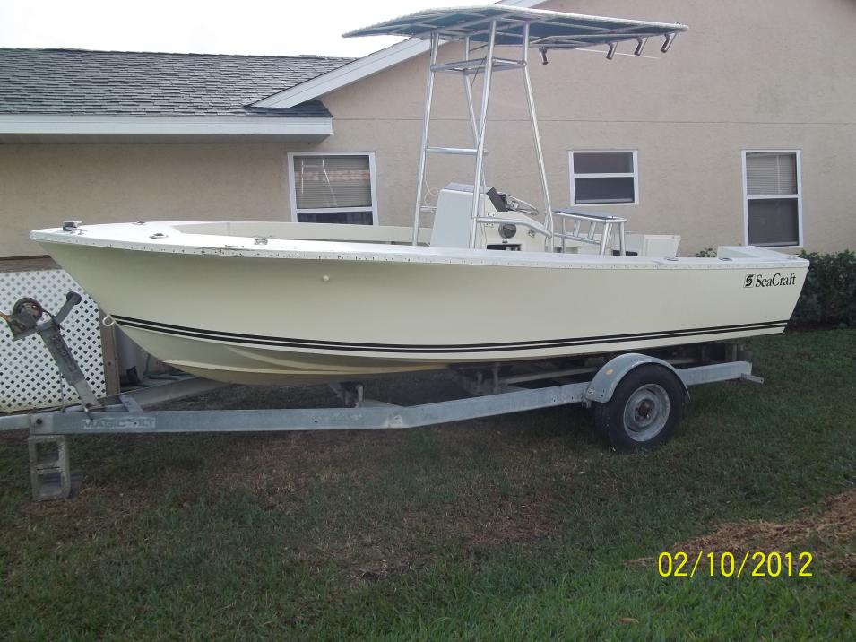

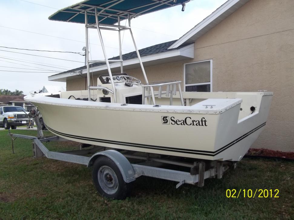

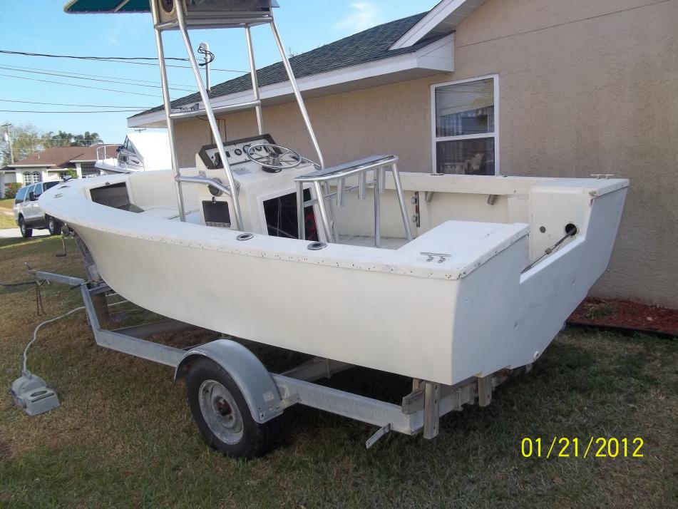

Well, I decided to start one main thread on my 18sf instead of jumping around and confusing myself. Again, I purchased boat for son to use in about 10 more years..I will use till then!!!
I decided to concentrate on hull sides first to keep the neighbor happy!!
I used Interlux Primer and finish coat I used Interlux Perfection. I filled holes gouges etc, faired and then sprayed the primer and rolled the three final coats. Do not have to worry about raising transom already done from inside. After discussion with other CSC members etc. I decided to go with a basic white exterior and black boot stripes with basic black decal, due to ease of touchups and minimal fading etc.
Next I will focus on rubrail and exterior hardware (bow and stern eyes etc.). Then I will move to interior- fuel tank replacement, recore fuel hatch etc. etc.
I will update on progress as time permits (doing this in my spare time). I plan on keeping this boat as simple as possible!!!
Here is where I am now..final coat on exterior completed with stripes and basic stickers.
-Fred

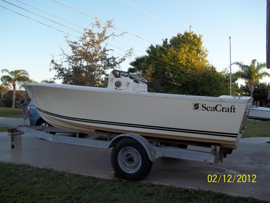

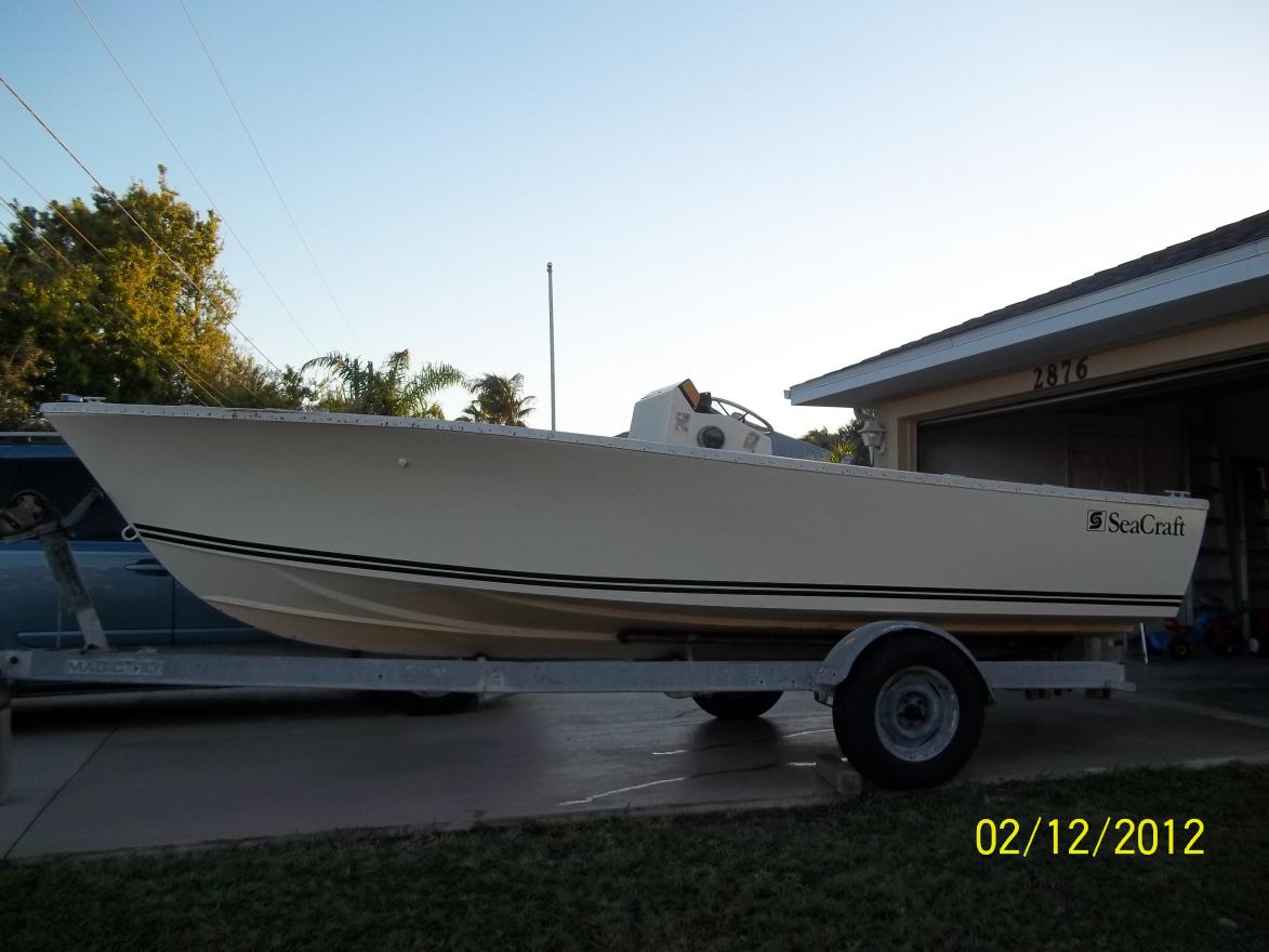

Thanks guys for the comments and motivation..again just keeping it simple.
Today I was able to remove the t top and leaning post. I think I gave myself a hernia lifting top off of boat!!!!
I also just did easy things today..just cleaned up the stern eyes and installed the ball scuppers...
I got a 6 month old Lab yesterday so he and my son took up most of my time!!!!
Some pics..
-Fred

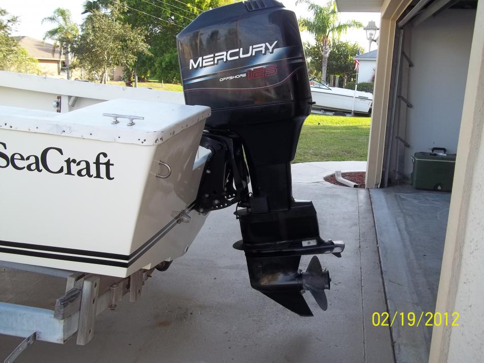

Well..I have not done much to hull. I did get a 1998 Merc 125 mounted on the back though with the help of Don Herman. Will start more work on hull next weekend..... time and interest permitting.
I also have a new to me trailer coming...my trailer has seen better days.
Figured after talking with other CSC members that this motor will be fine and it is under 350 lbs. I took a ride on my friend's 18' with a 150hp and it is just too much engine for me.
Here are some pics
-Fred
