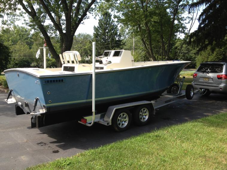

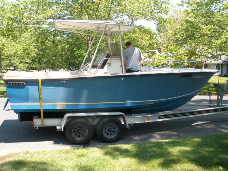

Well after almost 2 years my 23 inboard is almost done. She was stripped down to a bare hull and built back up to a nearly new boat. I still need to decide on the top so anyone with ideas fire away..
here are a few before and after shots
jim

What do you have for power in there?

Oh nice job! Looks real clean

It has a 5.7 Crusader with a BW 1.5-1. and a 17x17 prop. runs great with this set up.

What kind of speed and hp do you have?

I cruise at 3100 rpm is 28-29mph on gps. Tops out at 38mph at 4400-4500. I also ran it with a 16x16 4 blade and it cruised at 26-27 at 3100 BUT topped out at 39mph AT 4600. That is with about 50 gallons of fuel and not loaded up with all my gear.

good numbers. Nice looking boat!

Very nice and great numbers. Is that inboard efi? Are the hull sides "stars and stripes" blue?

good eye yes its stars and stripes.. with a cream color interior. The engine is 4 barrel carb. it an 01' 5.7 Vortec
