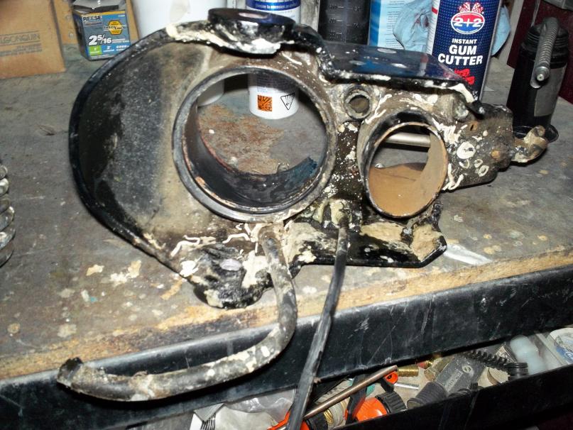

below,is a merc "alpha 1 gen II" drive,this drive is 11yrs old,the hydraulics - trim cylinders and all lines are original,the drive has never been "apart",water pumps have been replaced,this is the second time i've replaced bellows on this boat.the engine's also original,and the boat's wet stored,for the season - april to october,every year...
drives,the need to be removed every fall,upon winterizing the boat - do not skip this process - pull the drive ! there's no way to lube the fitting on the u-joint,without removing the drive,there's really no better way to inspect the drive shaft bellow,without removing the drive,and,last but not least,there's no way to lube the input shaft for the drive,with out removing that drive...again,do this,regardless of what mfg or type drive you have...
bellows:should be replaced every 5yrs.inexperienced people will tell you if the drive shaft bellow leaks,you're gonna sink,on the spot - WRONG ! way wrong ! on a merc,the water will trickle out of the "weep hole",only a small amount - as you can see in the pictures,the o -rings around the shaft these will seal the water at the gimbal bearing...
shift cable bellow:inexperienced people will tell you,it will sink your boat on the spot as well,again,wrong,way wrong ! the hole's slightly larger than the shift cable's outerjacket - small amount of water...
exhaust bellow:this will sink you on the spot,is what's said by the know it alls again - wrong,and again,way wrong ! the ehaust is sealed from water - the bellow just connects the exhaust to the drive...
