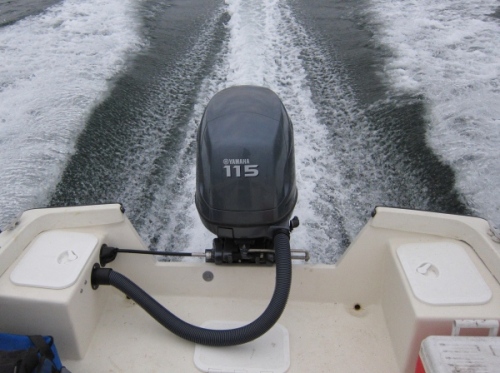

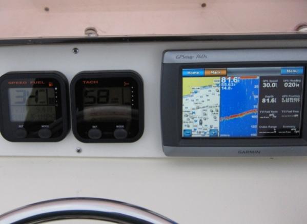

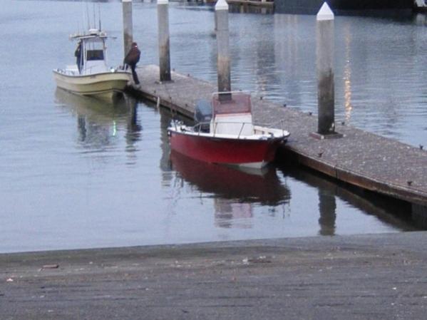

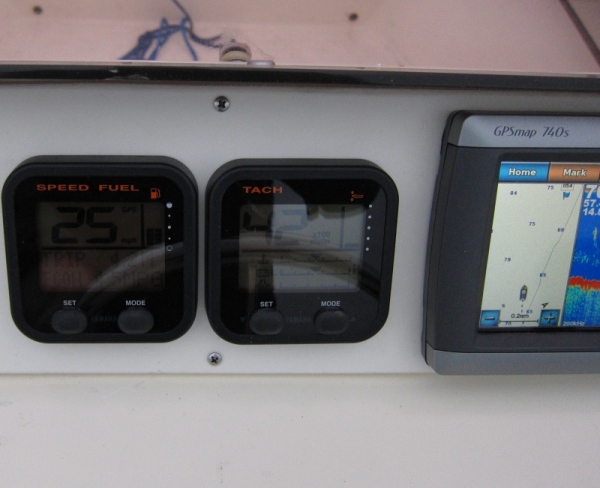

Just got my boat wet for the first time after a year long rehab. I thought I would put this in the performance section since I have some data on the boat with a Yamaha F115 and Solas Amita 13 1/2 X 15 prop. I actually hit 6000 at 37mph when I trimmed the motor up until close to breaking loose. Just me in the boat with 40 gallons of fuel. Still need a few details like putting in my lean post and bait tank, fabricating a console door and anchor locker door, plus some trim around the gunnels. I'm pretty happy with the performance I am getting but may try a stainless in either three or four blade. My options on props are a bit limited, the Yamaha is a lefty!
