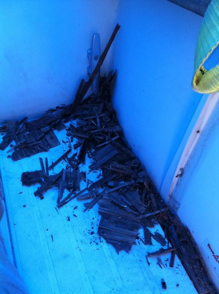

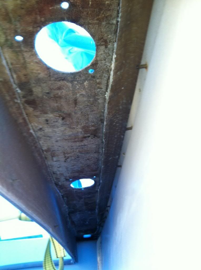

My cap rails near the aft part - around the rod holders - are soft. I am attempting to re-core them from underneath so I don't have to take the entire cap off. This would be a massive project beyond my skill level, and I think I'd have to cut somewhere across the forward bulkhead to get it off (Savage). Removing the cap is not an option at this point. The sections I'm repairing are roughly 3 feet long by the width of the cap rail.
So far I have removed the old fiberglass skin on both sides from below and removed most of the rotten wood. I think it was balsa core. There is one section of plywood that held up a lot better - wet but not rotten. I have not removed that section yet, as it's in there pretty good.

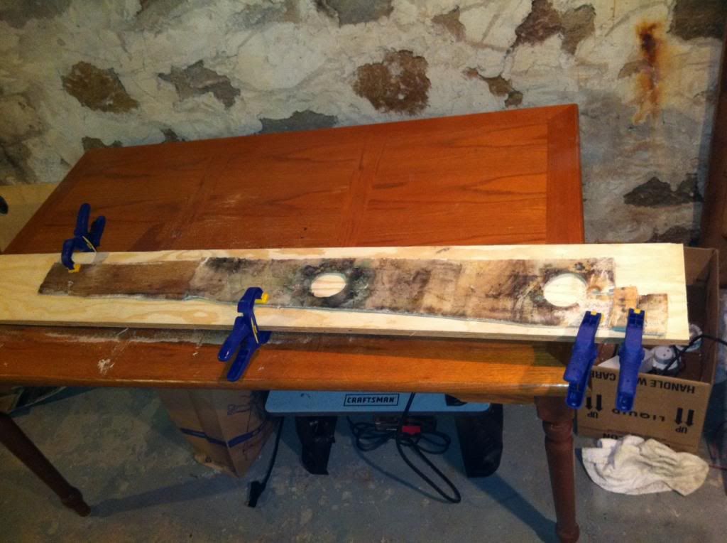

My plan for the re-core is to use 3/4" marine ply with some thickened epoxy and cover it with 6 or 9 oz cloth. The good news is it doesn't have to be pretty, at all this is being done on the underside of the cap rails. I'm planning on holding the new wood in place with either some big clamps, or with a bottle jack and the tire jack from my car while the epoxy cures. At this point I'm looking for some suggestions and constructive criticism. Any tips on getting the wet plywood out, prepping the surface, holding the new plywood in place, materials to use or anything that will make this project easier?

Removing the Old Wood - Wood chisels and a hammer to lightly tap it. You have to be careful not to angle it too much or you will punch through the top layer of fiberglass. A flathead screwdriver works pretty well too. Once most of it is out then you want to let it dry and then hit it with some kind of a sander. I don't know what kind of space you are working with a but a small "mouse" type sander with 60 or 80 grit paper would probably be your best bet.

I just did something similar on my contender. luckily the rear gunnels on mine are removable. I had to recore them as the wood around the rod holders was bad and further in the wood was still good. I found the easiest way to remove was use a dremel multi-max with Rockwell brand plunge cut blades. takes it right off without a lot of dust. I tried the chisels and hammers and screw drivers. dremel was by far the easiest and fastest option for me.
Old 05-19-2013, 10:35 AM
Ditto on the Dremel multi-max. You can set the depth perfect and it will cut in slight curves versus a straight line only!

Thanks guys. I used a Dremmel type tool and I seriously don't think I would have been able to do it without it. Some of the wood was a bastard to get out, but I was able to get it out piece by piece with the multi tool.
So far, both sides are cut out and sanded and I've cut and dry fit the new plywood. I used the old fiberglass skin as a template.
I taped off and covered the aft gunnels and deck with a painter's tarp as the next part of this project will get a little messy. A friend suggested screwing the new boards in from above to hold them in place, so just I'll use the holes from the rod holders.

Screwing from top is a good suggestion. Use SS just in case they break off. You don't want them possibly rusting and bleeding through later on.

If you have a Harbor Freight nearby, extra long C clamps work pretty good and it looks like they may be long enough to fit there. I used these a bunch of times doing my rebuild. I used 6 mil plastic sheeting so they don't stick to whatever you are using as bedding.

Great advice, thanks guys. I am going to screw the boards in place without the thickened epoxy to make sure that will work. Otherwise I might try the clamps. Good call on the tape and plastic wrap.
