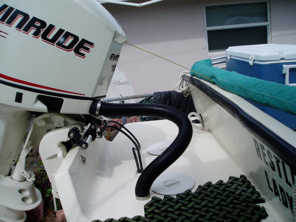

Adam, if you're rigging a boat with a bracket, instead of just running everything out the transom and across the swim platform, it'll look a lot cleaner if you run the rigging thru the flotation tub and then up through the swim platform. That's the way Don Herman and Caymanboy have rigged their brackets, and Don sells rigging kits for it. (You'll need an access plate in top of bracket to do that however.) Denny

I would definitely plan to do it that way. Looks like it'd be fine running down the center then. I'm just planning my stringers right now and wanted to see if I need to leave the nothches for the rigging or just glass over them as I raise the deck. Thanks folks!
