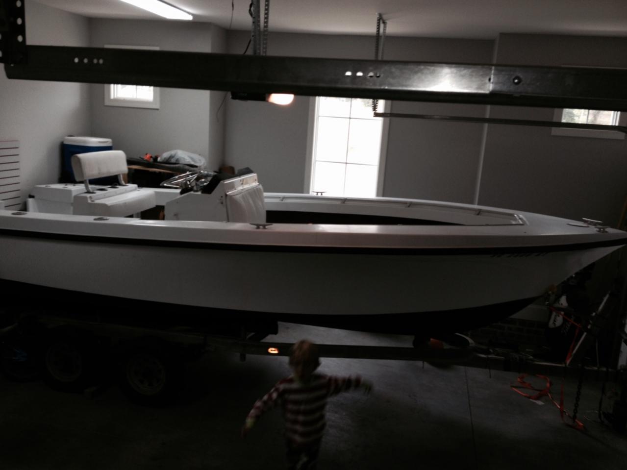

I still would be interested in seeing a picture of your SeaCraft and it's console. I'm not convinced it's a MA

Default Boat Pic
This is a picture of the boat before I bought it. If it isn't an MA that won't worry me any as I do like the boat regardless

Your existing console is smaller than the one that came in my 20MA. That sure looks like my 75 MA. Mine had a console with a head in it. At 38" wide it is not all that easy to move fore-aft, but not terrible. But finding room to mount a t-top to the deck becomes problematic.
Mine had a swing out door so you can get to the head. I cut the door off, put a tank inside the console and use a cooler as a seat forward. This year I will put a 2nd tank where the cooler is. I put flotation foam where the 50 gallon under deck tank was.
If that is a tank filler cap on the starboard side, the cap can get in the way of the filler. I have a 45 degree inclined one. If that is freshwater fill, then the dock hose shouldn't be an issue.
