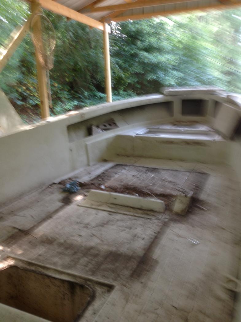

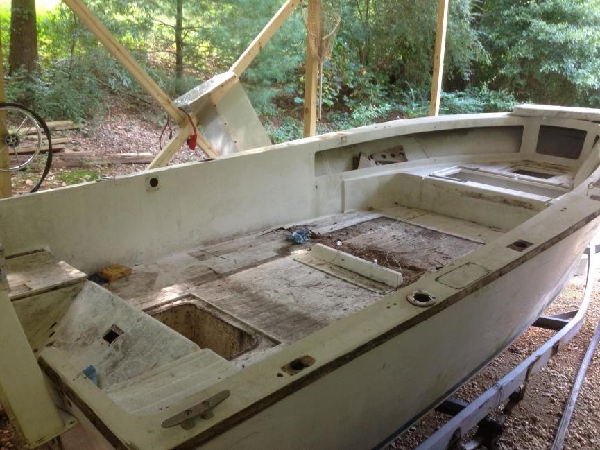

well got started on the tear down this weekend, got her disassembled and ready to pull the cap, every thing came apart fairly easy ill I got to the fuel tank, then I found the Potter foam!!!

Foam helps hold water against the tank to cause the equivalent of crevice corrosion, so might as well plan on replacing that tank! Use a pressure washer to blow away all that foam and remove the tank! And DON'T foam in the new tank!

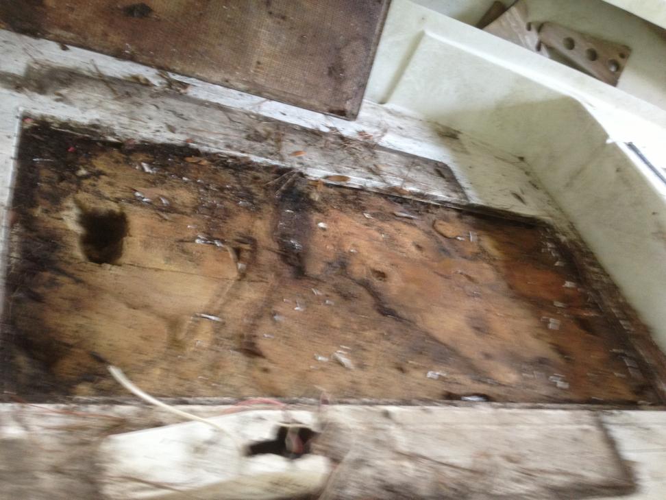

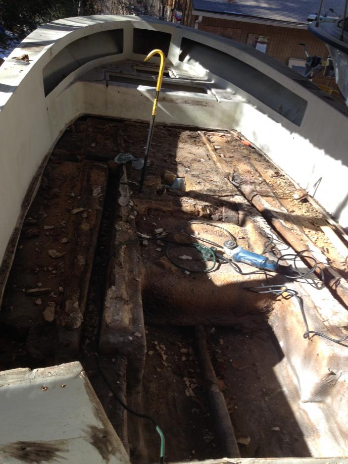

Ok, been a while since I posted anything, put the 20 on the back burner for a while,{deer season in Ga is 4 months long } back on it for a few hours here and there this past few weeks,got the rear deck cut out and the rotten transom removed , then I finished cutting the floor out and got the deck separated from the hull , I dug the foam out around the fuel tank and got it lifted up and our of the hole, now on to clean up and getting all the foam removed, any tips on the best way to accomplish this?

few more with the transom bout removed

deck off , all rotten wood removed, tank and foam removed, almost time to start construction instead of destruction!!!!
Im trying to do this with out removing the front liner, anyone else done it this way?

You asked about getting the foam out. Well, for getting every last bit, I would suggest:
I would pull the tank deck/floor, then pressure wash. Then pressure wash with soap, like simple green to degrease. Then pressure wash with clean water. Then grit blast anywhere you want to glass or paint, then pressure wash with clean water again. Then you are cleaned, and you don't need to sand.
