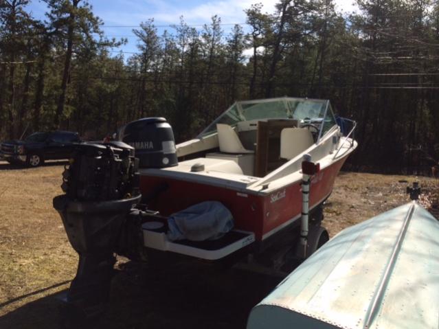

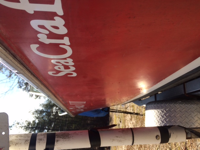

Just picked up my first Seacraft, 1972 Seacraft Seafari that I bought off a fellow classicseacraft member (thanks again Alan!). Has a 2000 Yamaha 100 HP Fourstroke and a continental aluminum trailer under it. Needs a little bit of work but I am pretty excited to get into my first seacraft. From what I was told by previous owner, the boat was converted from an I/O by Bigshrimpin, and then purchased by the previous owner who added a custom aluminum bracket that is on the boat now. Picked it up today and couldn't wait to get started on getting it ready. I already tried a fiberglass restorer/wax to bring back the original gelcoat. It definitely helped a little but I am going to try a color restoring and rubbing compound to bring it out more. Besides that I made a couple of backing blocks out of 1/2 marine ply for the outrigger mounts to provide some strength. Other things on the short list I have planned: Repair crack in back corner of the port gunnel, install a second battery, install new Raymarine A78 MFD unit, and if I have find the time after that refinish all the woodwork. I tried attaching some pictures, hopefully they work. Any thoughts, comments please let me know what you guys think! |

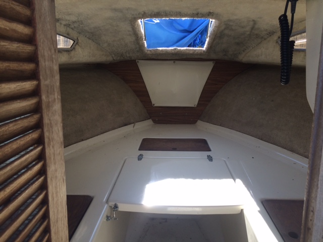

Try Shockwave for some mold relief in the cabin

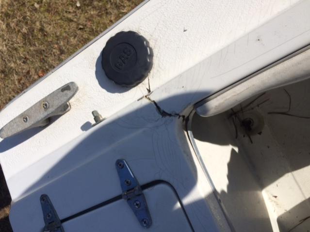

Nasty crack. Any idea what caused that? Anything underneath in the liner or hull? |
I think the crack formed from the installation of the gas fill. It doesn't travel "down" so to speak, its definitely just the gunnel.
I plan on bracing it up into its correct position with a bottle jack/block, and glassing it back into place from underneath in bulk to add strength to it. I may even add a few permenant braces under the gunnel so in the future people grabbing it and stepping on it don't re-crack it. Then on top I can sand the area down and use west system to fill in the cracks, and refinish so it looks nice and clean again. Otherside is still strong, its just that rear section on the port side. |
