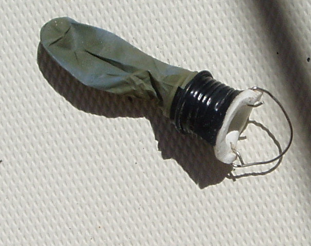

If the scupper tubes aren't leaking, you can use the "Vortex"/duckbill type checkvalve invented by forum member Fellowship years ago (PVC version pictured below), or the copper pipe version used by BigEasy1 and mentioned in a recent post. I like the copper pipe version because of the larger flow area, and they're evidently retained simply by gravity. The PVC version, which is simply a PVC slip/threaded adapter with most of one end cut off and whittled away with a dremel tool, is retained by a 7/8" OD/3/4" ID "O" ring you can buy at HD or any hardware store. It works pretty well and I use them when I'm diving when the deck is gonna be wet anyway, since they will automatically drain water off the deck as soon as you start moving. However if you're anchored up and folks are sitting in the back seat, they will slowly seep water. However my '72 with the 427 lb motor sitting 30" back on a Hermco bracket is just barely self bailing at the dock, with the waterline about 1" or less below the deck, and wash down water will drain off with no one in the boat. The decks were raised at least an inch in about '73 when Potter changed from the original Moesly 4-stringer design to 2 large box stringers. The recess around my scuppers is about 1" deep; if that recess on your boat is 2-3" deep, your deck is a bit higher than mine.
