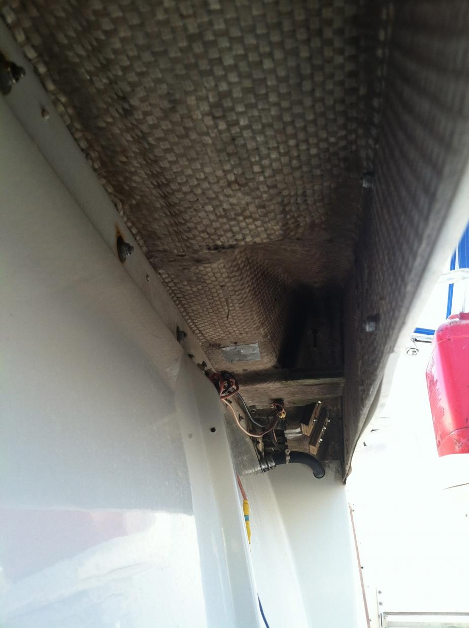

Here is an underside view of the port gunnel looking aft. I want to add support to make it much stronger and structurally sound. The blocks of wood are supports to the hardtop and you can see all has been thru bolted.
As this site is all about taking a classic and making even better - I'm hoping to get sound advice as this is not an area I'm familiar with. I think adding core all around including the curves will tighten it up ( what a PITA !! ) but want some insight.

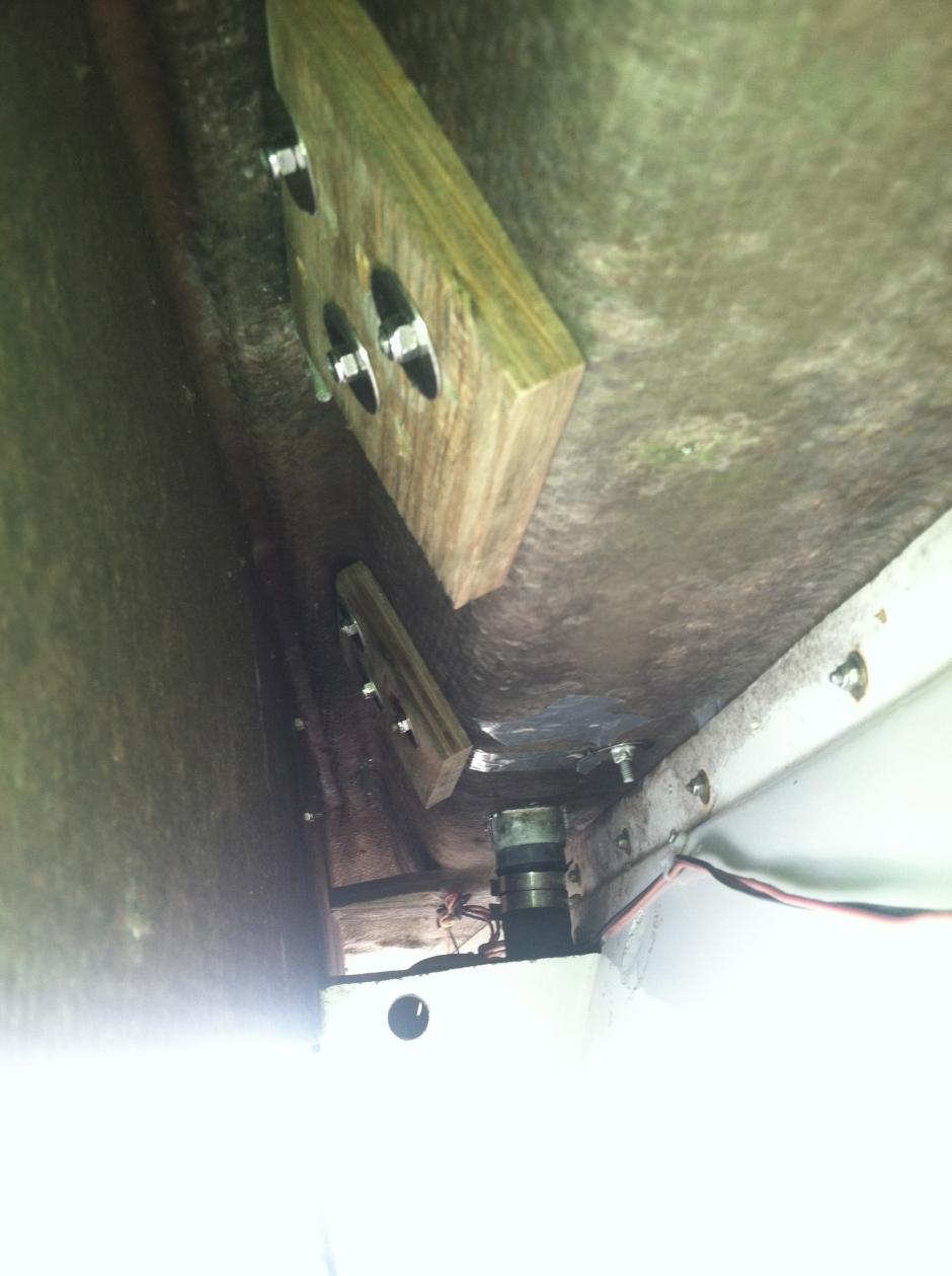

This is different view - same side, but aft looking forward

I think if you made a core with skins like mine on a laminating table or atop the cap to achieve the desired compound curvature then you can build them right side up then bond in place?

Hmm. Not exactly sure what you;re describing. Are you saying to use the topside as a mold - a female plug ?
Once solid, add wax/ mold release on inside of that female plug, glass in core material, then pop that out, cut and use cored pieces as needed ?
Old 08-10-2015, 11:41 PM
Location: Greater Boston
Posts: 1,117
Not a plug, per se, but a curved surface. If we assume that the core in the cap is a constant thickness, then if you were to wax/pva or just polyethylene sheet the cap, then you could lay down a layer of mat or even 1708 and a layer of core and a layer of mat, or even 1708 on top.
That way you make a sandwich core that conforms to the curvature of the underside of the cap. But you lay it up right side up.
The bottom layer of mat/ 1708 would be the underside of the core. Once that all kicks you could flip it over, cut a 45 degree bevel around the edge and put more glass over the bevel. Then you have something like the inverted trapezoid I made for a "hat channel" stiffener for my deck, except it should follow the underside of your existing cap nicely. Of course you want it to be less than full cap width. Then you sandblast the underside of your cap, wash with acetone and bond the additional core in place like an oreo. Or grilled cheese sandwich. I'd use VE or an epoxy thickened with some cabosil and structural thickener. You will need a bunch of C or bar clamps or welding clamps.
I hope this makes sense. I haven't tired this, but it is a variation on the deck support I made.
