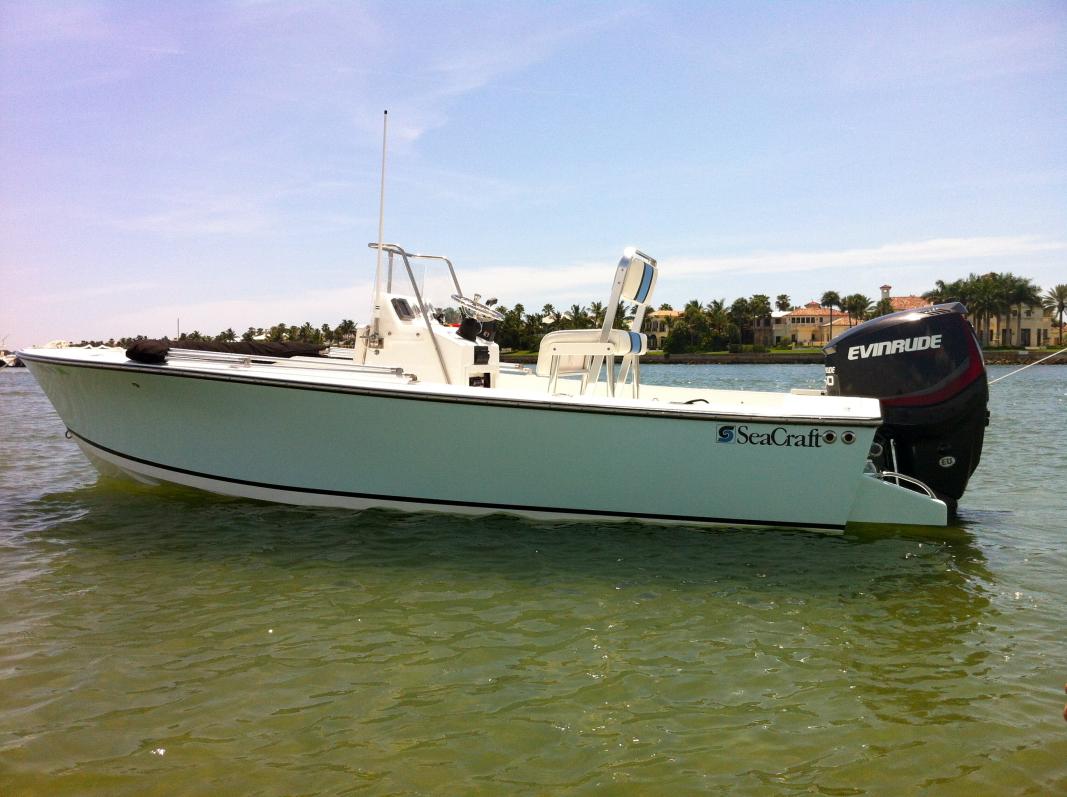

I finally pulled the trigger and went with an 150 Etec hard to pass up that 7 year warranty.Just in case you are wondering shes a 1978 18 ft

Yup...gonna need more pics of that one!
Old 07-25-2015, 10:45 AM
Location: Brewster, MA
Posts: 396
More pics and specs needed. Original floor height? Does it still self bail? Speed and economy? Sweet 18!

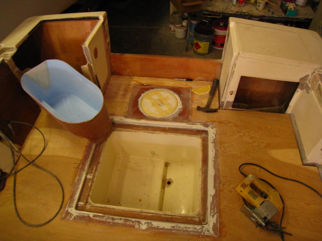

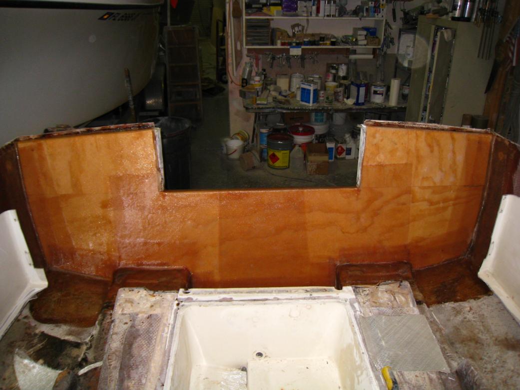

Thanks,here are just a few photos of her resto ,I raised the floor 2 inches moved console forward 8 inches batteries under console and have no problem with self bailing.The motor has been on only 1 week at 3500 rpm 36mph and 4.8 mpg 2 men full tank gas 50 quart cooler.

Wow!! You did a beautful job on that resto.More pictures would be great.It sits so nice in the water.Congrats.
