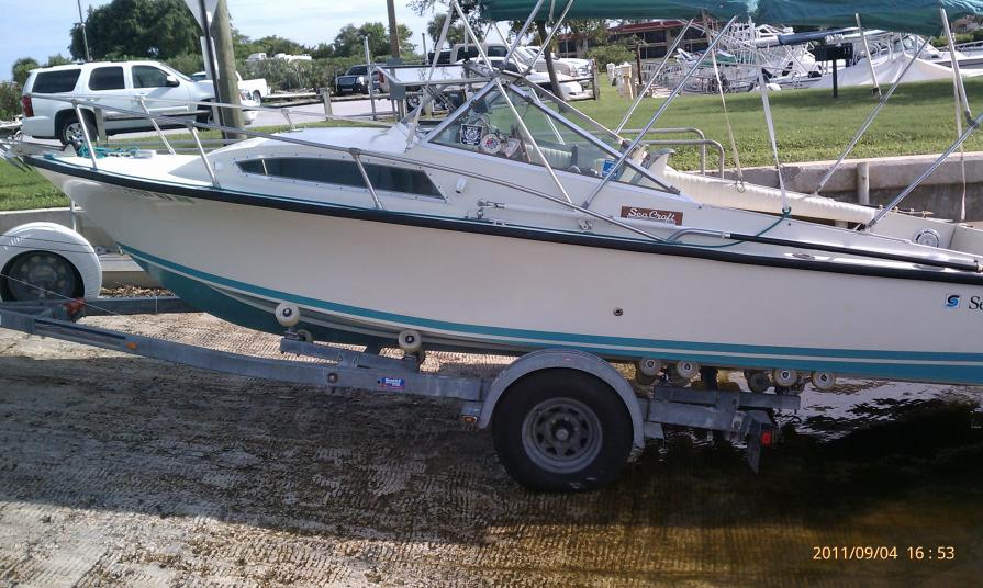

I believe my bunks are made of cypress (23 years old now). They taper down from front to rear. They were re-carpeted a couple of times and I kind of experimented on the carpeting the last time and the gray that I used is working better. Excuse the nasty bottom paint,I was hoping that it would eventually wear off by now.
I was wondering if you were winching the boat up on the trailer or trying to float it on the rollers. Personally, I hate rollers.

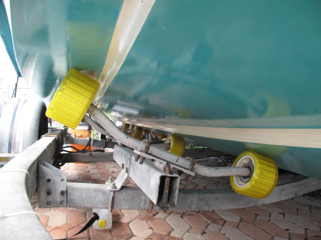

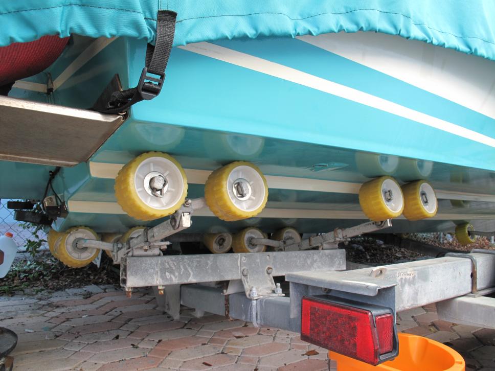

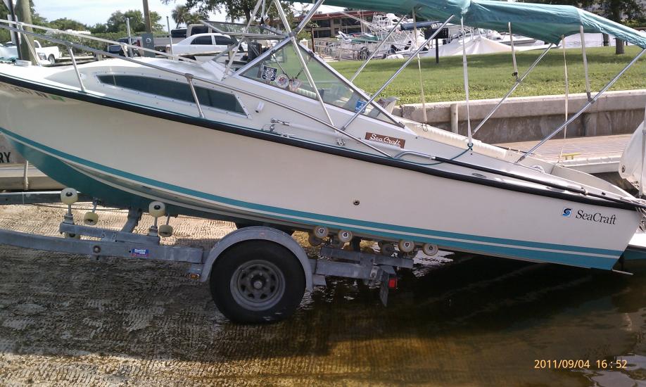

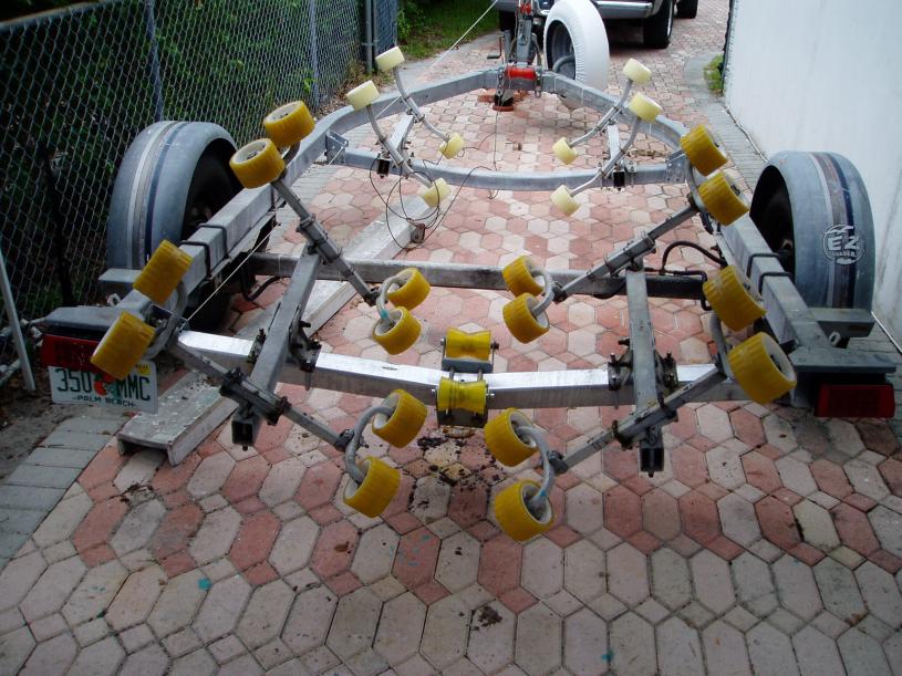

Can you post some pictures of your roller set up? Take a look at first picture of my trailer below . . . as soon and the center of hull touches and pushes down on the inner rollers, the outer rollers pivot up and contact the hull, so there is no way it can heal over at that point. The center rollers on aft cross member keep the boat centered for the first few feet but once those outer aft rollers go over the edge of the step between the outer and center panels, the rollers run right along the step and guide the boat perfectly every time, just like it's on rails.
I suspect you may be dunking the trailer too deep instead of winching boat on, so the rollers don't have a chance to "latch on" to the steps and guide boat on trailer. (Notice how dry my trailer is in the loading sequence below . . . only the tires get wet!) Or maybe your trailer doesn't have the EZ-Loader setup with counterbalanced rollers. If you can post a picture of the roller set up, maybe we can figure out the problem. One problem I had when I first got the trailer was that the EZ Loader system has so many degrees of freedom, that if boat isn't balanced and lists to one side in the water, it would tend to come on trailer the same way. But once I got the rollers adjusted correctly so the run right along the edge of the vertical outer step, that problem went away.
