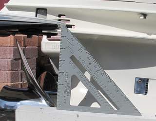

So before launch for 2016 I decided to raise my motor up a bit on my 1975 SF18 to see if I can help with my high-planing speed and general drag-ass performance I had last year. (see this thread from last August)
I know it's been mentioned many many times by a bunch of you guys in the know (looking at you Bushwacker. ), that the motors Anti-Cavitation plate needs to be approx 1-1/2 to 2 inches above the bottom of the keel at the transom for optimal Seacraft performance.
As the boat was set up from last year the Anti-Cav plate was just below the bottom of my keel by about a 1/4 inch, so I raised it up 2 holes.
Now the Anti-Cav plate is about 1-1/4 inches above the bottom of the keel, but it looks kinda weird.
Theres still one hole to go up so its not maxed out, but it just looks kind of odd.
Couple of my co-workers at the boatyard here were assisting me and they all thought that what I was doing couldn't possibly be right.
Here are a couple of pics.
I know she needs a sea trial to really know whats going on but Nantucket Sound has been a lumpy mess all week with winds consistently out of the southwest.
When I finally get out there, I guess I should be looking for prop blow out, and the Anti-cav plate running just about at the surface? Anything else?
Can you guys take a look and let me know if this looks right? Again, this is on an 18 footer with a 115 Mercury 2 stroke.

While I have been wrong a lot and occasionally right, I'm thinking you are very close to right on. Whats the the center to center distance on the holes - 1/2"? You probably have all the adjustment range you need. After you dial the height then dial the prop. The prop gurus are way smarter than me on that - I would call Ken Reeves at PropGods.

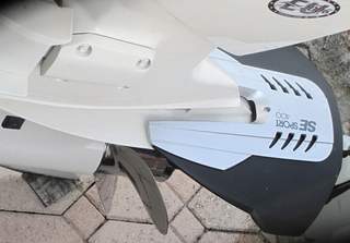

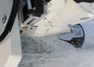

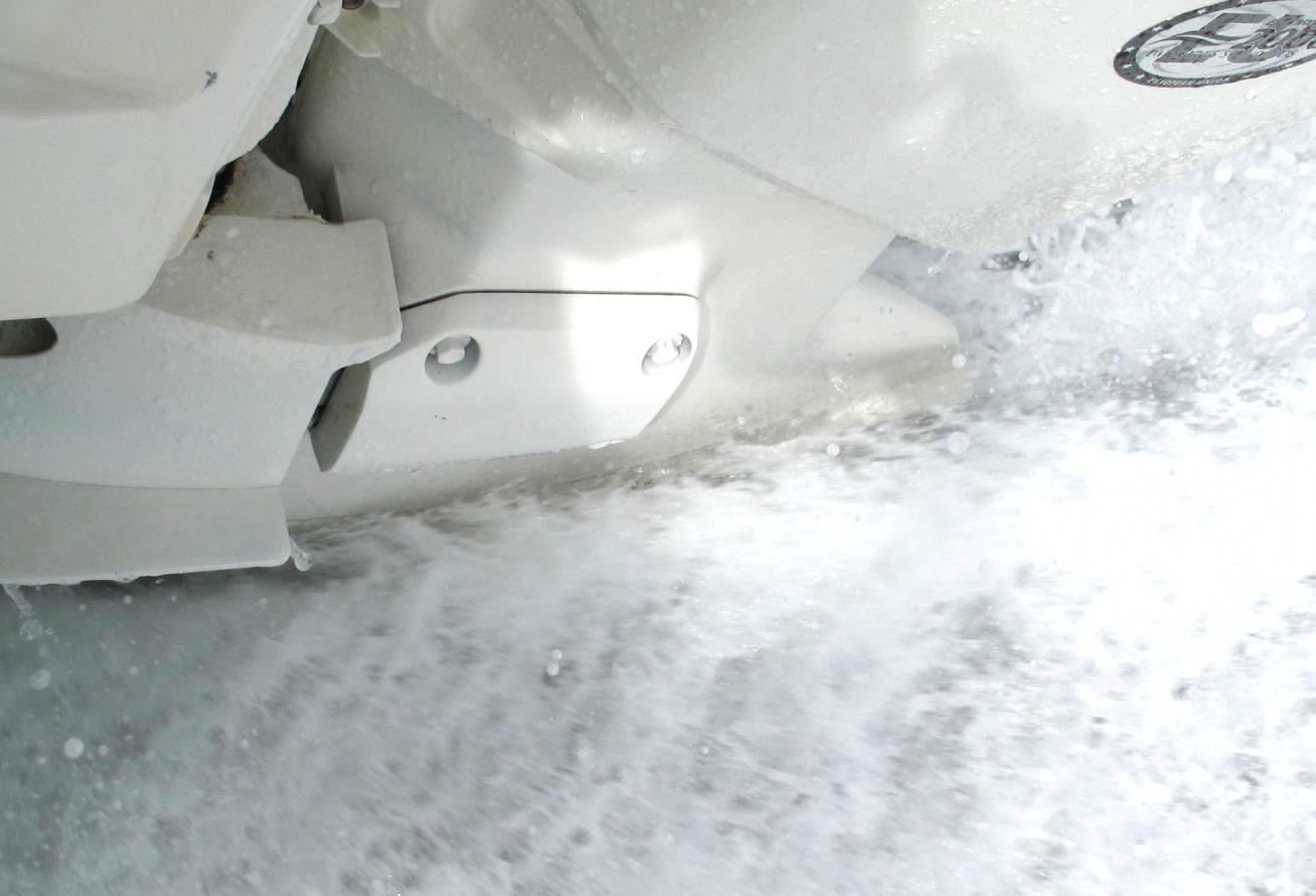

The pics below show what it looks like when motor is too low and just right. 2nd pic is with AV plate at 3.25" above keel, which is as high as it would go without a jack plate. (I had to focus on the black fin I added to AV plate, because it's pretty hard to see the white AV plate in white water!) Since I have a bracket with a lot of setback, I ended up installing a small 3" jackplate because the widely quoted rule of thumb of "raise motor 1" for every foot of setback" appeared to be totally bogus! Last 2 pics were taken after I raised the JP as high as it would go, and AV plate is now at about 6 1/8" above keel with 33" of setback, so the correct "rule of thumb", at least for my boat, is about 2.23"/foot of setback!
