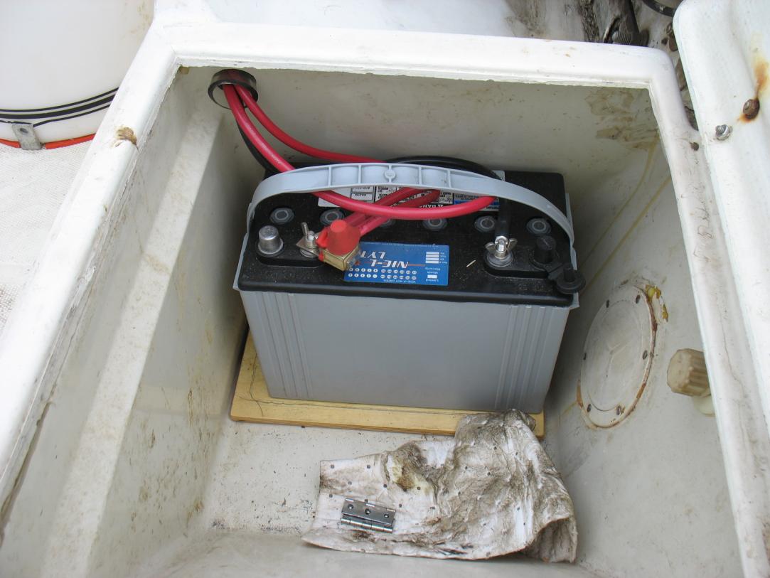

My boat is a '72 also; you will find that, if you dig out the foam between the stringers on the stbd side, that there is enough room for a large battery box and Group 27 battery between the stringers. I'm also able to stow 100' of anchor line between the batteries and a 9# Danforth stern anchor and about 8' of chain on top of the battery box. Attached picture shows my battery setup - at the time I was using an Optima Red Top battery in the stock location out at the chine, and you're right, there isn't enough room there for a battery box. I used the Optima because it's sealed and only weighed about 37 lbs. A big group 27 battery in that spot made the boat heal to stbd, and that was a problem with my roller trailer because the roller system has so many degrees of freedom that the if the boat was healed to one side in the water, it tended to come on the trailer the same way! That problem went away after I installed the Galley Seat and a 6 gal water jug on port side. The Optima battery eventually died after 7 years, so I replaced it with Group 34 wet cell battery that's about the same weight because I concluded that it wasn't a good idea to mix AGM and wet cell batteries in the same system, as they like to be charged at different rates and voltages. I often use the live well under port seat for bait so didn't want to to put a battery there, and I also have a port-a-pottie, so that location is also not an option.

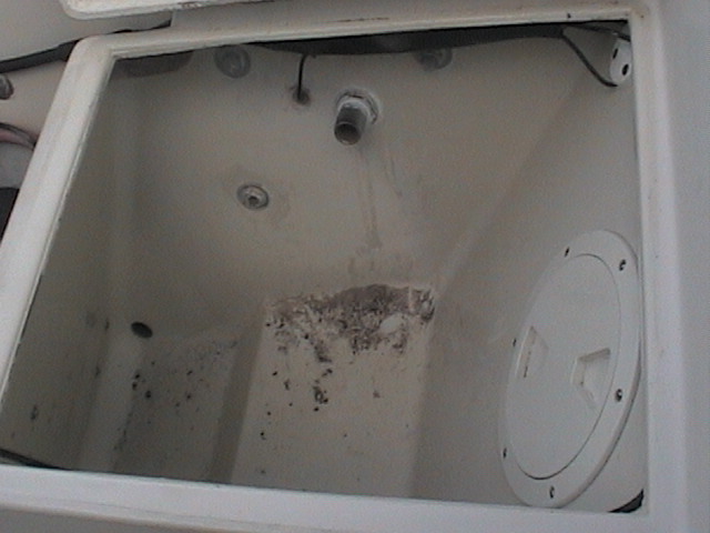

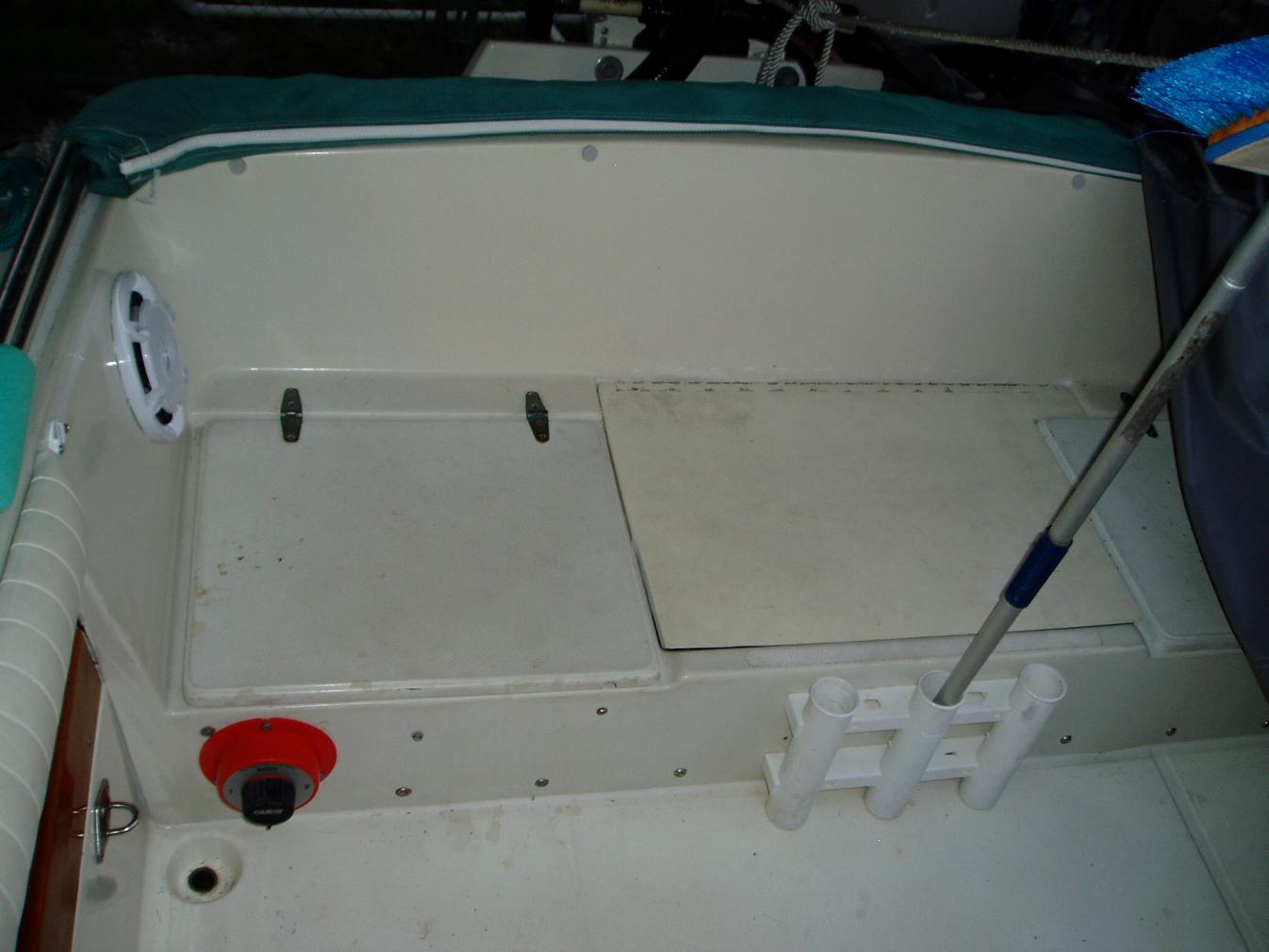

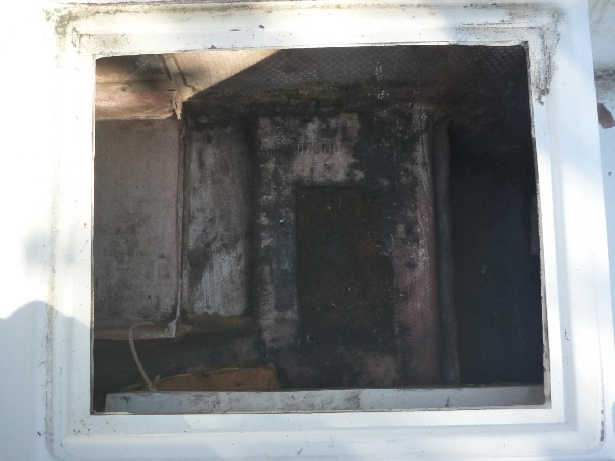

FYI Gilly and Sailor . . . there is a lot of room outboard of the baitwell, probably 6-8" between hull and baitwell. All you have to do is install a watertight Phyi plate in the port wall of the baitwell as shown in attached pic. I found a half dozen drain plugs and scupper plugs in there that had rolled back and fallen down thru the gap between the cockpit shelf and the inner liner/side of seat, after I cut the access hole! Makes a handy place to store spray bottles, bilge cleaner, OB oil, etc. One of the bracket bolts when right thru the original baitwell water inlet/outlet area (Don filled in that hole with some Coosa), so I had to add a thru hull for overflow/outlet and another water inlet to keep it functional.

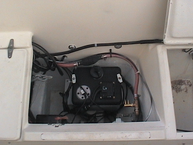

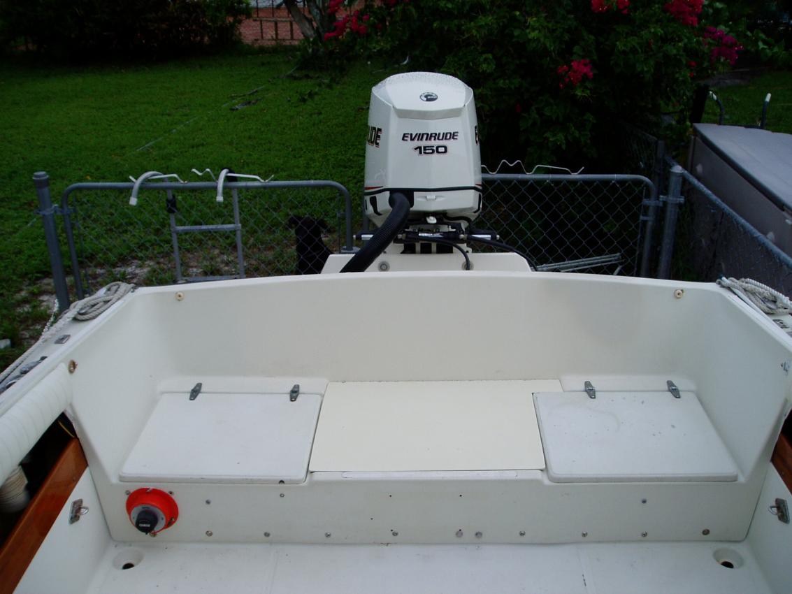

Sailor, installing a watertight hatch in the splashwell is a good idea, as it will give you access to a lot of storage under there. After I installed a hatch there, I was able to install a Racor fuel filter and trim tab pump in that area, plus it made it much easier to access the bilge pump. When he installed the bracket, Don cut out the entire splashwell, and I was able to install a hinged seat over that area, and I also installed the E-TEC oil tank there. Second pic show how much volume is under there. I'm also able to carry 3 fenders in that area after I added the seat/hatch.
