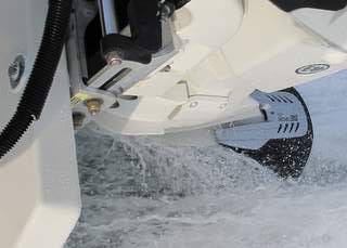

As for props, the 3B 13 3/4 x 15p OMC SST was a very good prop on my Seafari with the old 300 lb cross-flow 115 that probably wasn't more than about 100-105 hp at the prop. It would plane at 12 mph, burned about 8 gph @ 20 kts/23 mph/4500 rpm cruise (2.8 mpg) and run at least 32-34 mph/5500 rpm @ WOT with a very heavy load. That looper motor should be stronger and might be able to spin a little bigger prop, but I'd start with 15" pitch. I have an old Michigan 15 3/4 x 15p aluminum prop you can try. Make sure you get the motor height correct before you start screwing around with props; AV plate should be above solid water when you're up on plane like the pic below. I think I'd start out with it about 3/4" above keel. The Viper is BRP's very efficient bow-lifting speed prop and might give you the most WOT speed, but both Vezo II and Rickg couldn't get a Viper to hang on plane below about 22-23 mph! Low speed planing is real important if you run offshore very much, so depending on how much load you carry, a stern-lifting prop might be a better choice. I believe the SST II is a newer version of the prop I had, but once you get some initial test data, I'd consult Ken at PropGods, who would be more up to speed on the latest props.

How high you can run the motor really depends on the prop, as some props can run higher than others depending on how much cupping they have. I originally mounted my 115 with the plate flush with the bottom, but when I bought the SST prop, they said I could raise the motor 1 hole (3/4"), so I did and I picked up about 3 mph! This was way before I learned up about getting AV plate on top of clean water, so I don't really know if the AV plate was above clean water on my 115 set at 3/4". I just know that it ran much better there than flush. May have been able to run it even higher, but I never tried that. I did notice that I had to run with the motor trimmed down more to keep the prop from blowing out in rough seas, so I'm sure raising it more would have made that worse.
If your motor is like my E-TEC which has 4 holes, spaced 3/4" apart, if you mounted it so AV plate is flush when mounted in top hole (No.1), that would give you the following options on AV plate height:
Hole # - AV plate height
1 - 0.0
2 - 0.75"
3 - 1.50"
4 - 2.25"
Seems like this would be fairly conservative but still give you a decent range of heights and allow you to run anything from a cheap aluminum prop to a radical highly cupped prop. If you plan to only run a good SS prop, you might be able to set 0.75" as the min height.
Capt. Terry went through this on his Seafari in the last year or so and said his AV plate is on top of the water, but can't remember if he's at .75 or 1.5" height, as I think he's tried both settings, so we need to get Terry's input on this.
