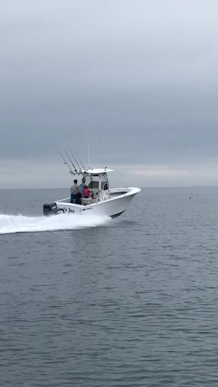

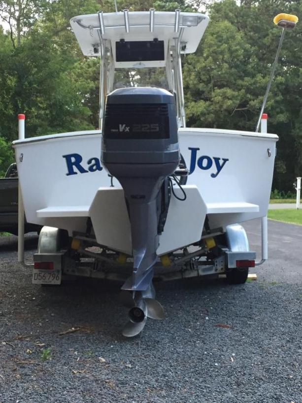

Hi guys. Just completed a closed transom with a 25" Hermco bracket. I mounted the bracket per Hermco 21" up from the bottom. I can only get 4" from the bottom to the cav plate at the highest setting. Just wondering if I did something wrong where some other guys can get it higher on a lower hole setting. Did they put the bracket higher. Also would the location of my trim tabs effect anything. I got 41 out of it with a 225 carb Yamaha 5200-5400 wot left hand rotation. Prop is a 17ML. I am considering looking at a stern lifting prob. I have attached a few photos. Any input would be great. Thank you

I don't have a bracket so I don't have any personal experience on this, however it seems a LOT of people wish they would have installed their bracket higher. That last pic with your boat on plane looks pretty sweet to me!!

Not sure on your Lenco tabs ???
Bennett recommends as far outboard as possible !
They will be working like a teeter totter the way they are now..

I agree, TJS's tab placement is way too inboard. As much as a pain it would be I would move them out.

Thanks guys. I was scared to cut the bracket for the tabs but after running the boat I think they would be better on the outer edge. I will have to man up and make the cut this winter.
