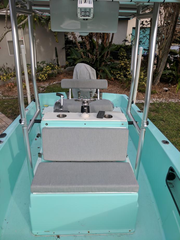

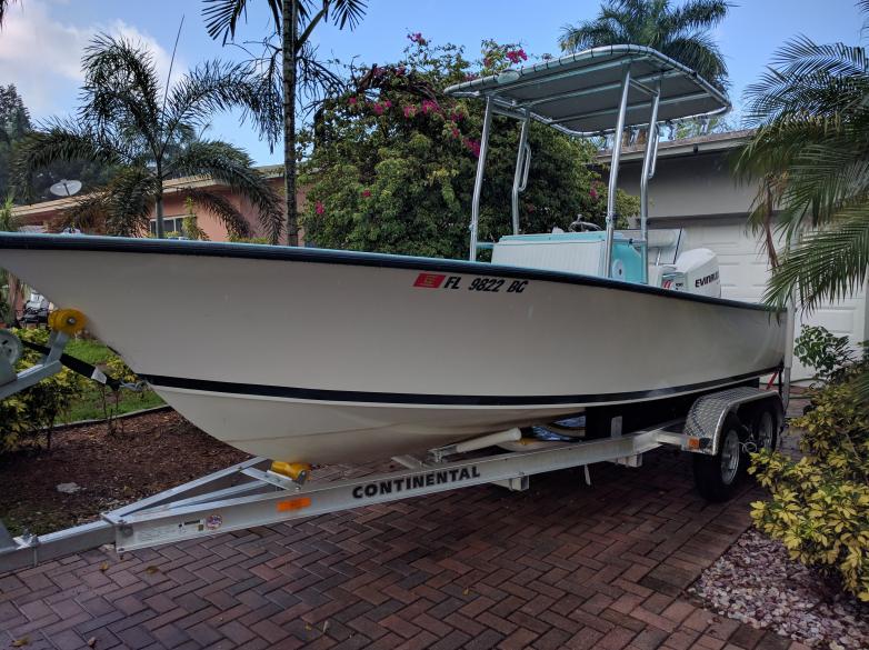

While I do enjoy this type work, I may get someone else to do fairing and paint. As things go, I have wants and the wife has needs. I'm sure we'll meet somewhere in the middle. I have attached some pictures of current state. Look forward to contributing and continuing to read everyone's tales/info.
