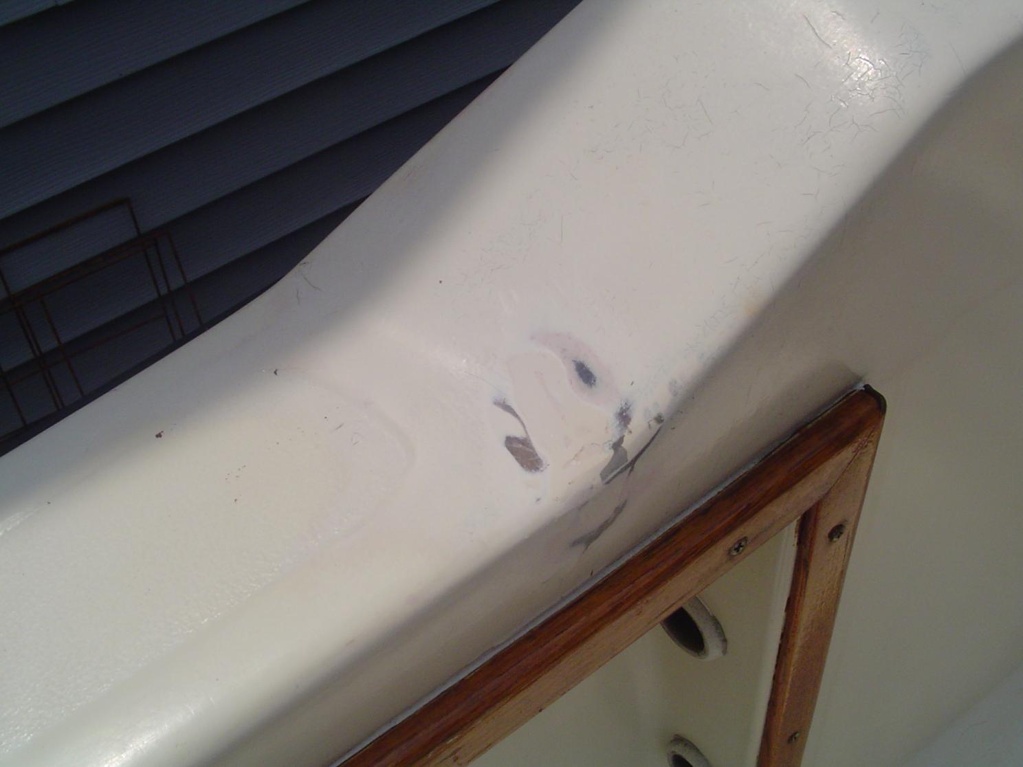

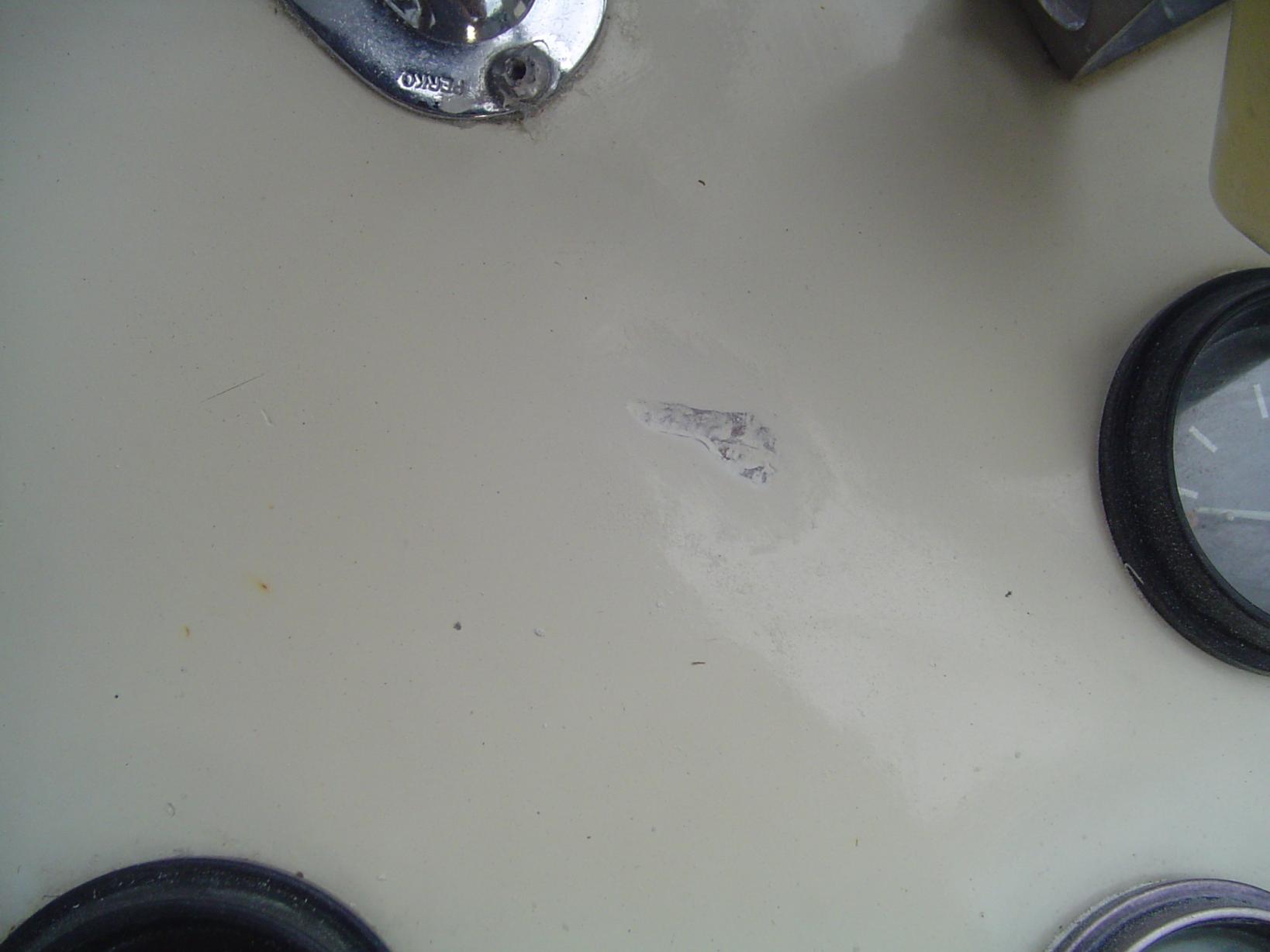

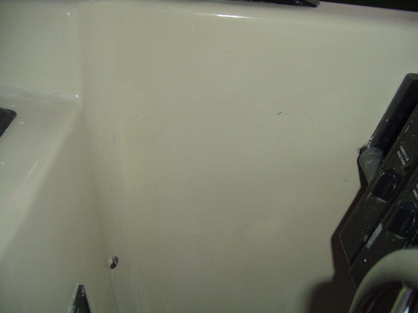

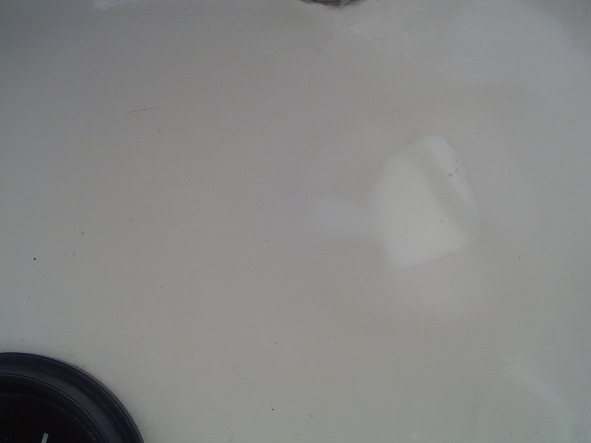

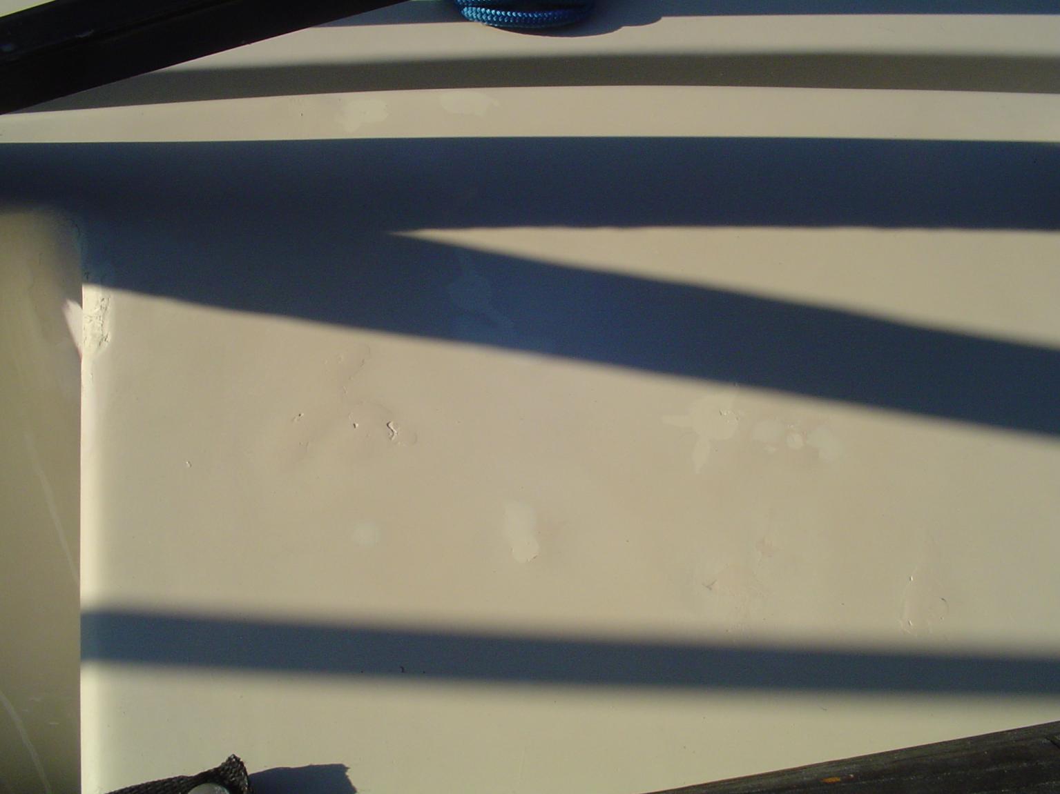

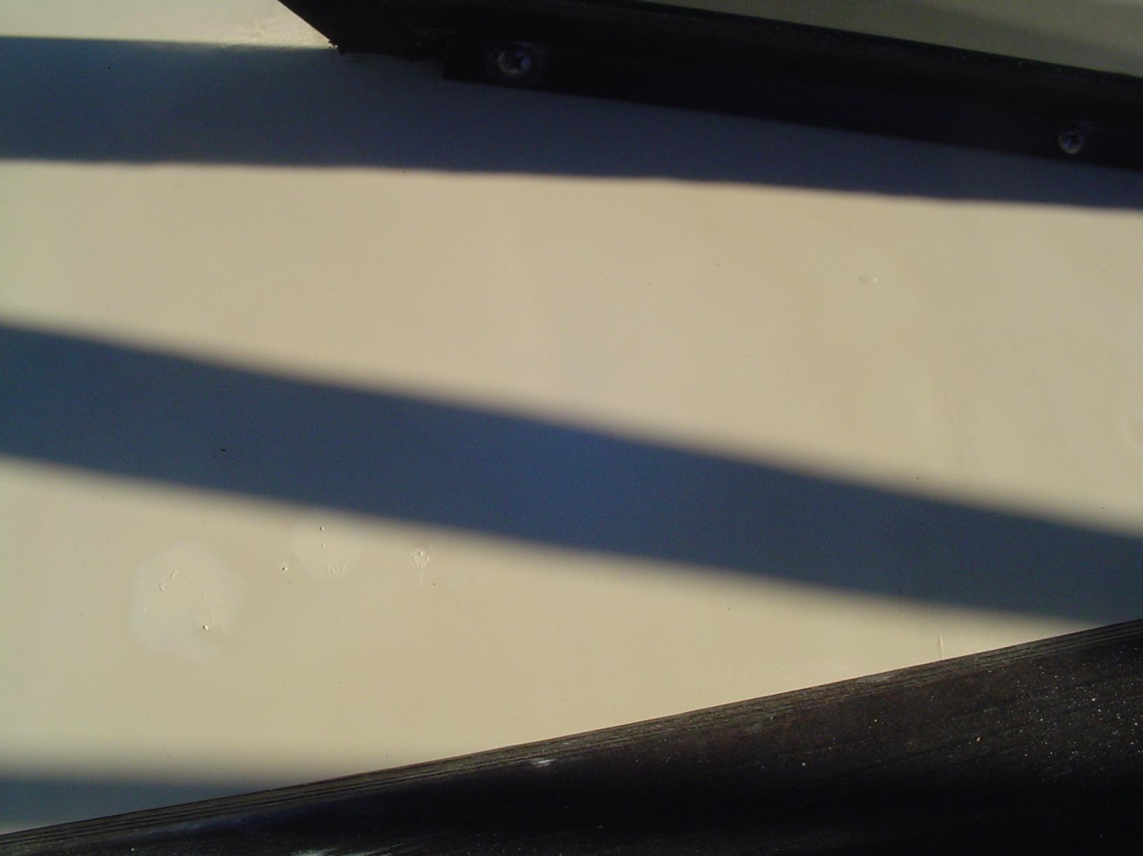

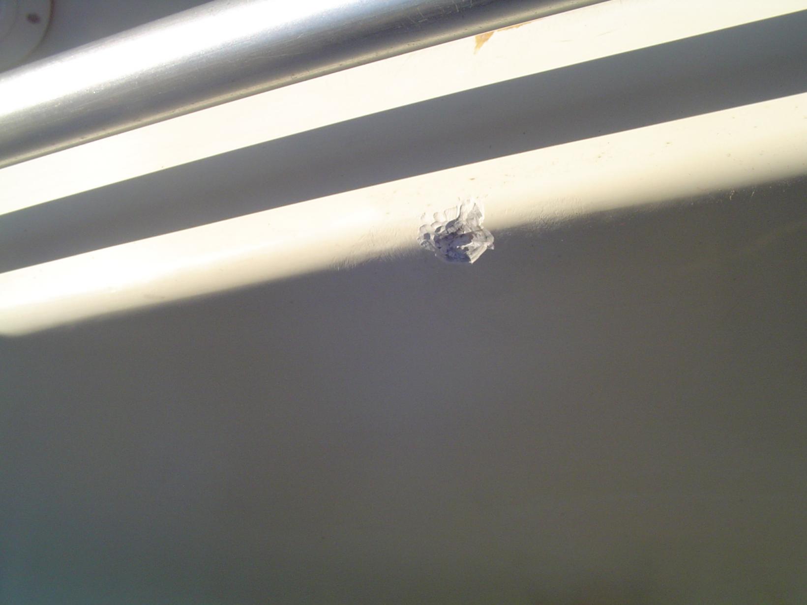

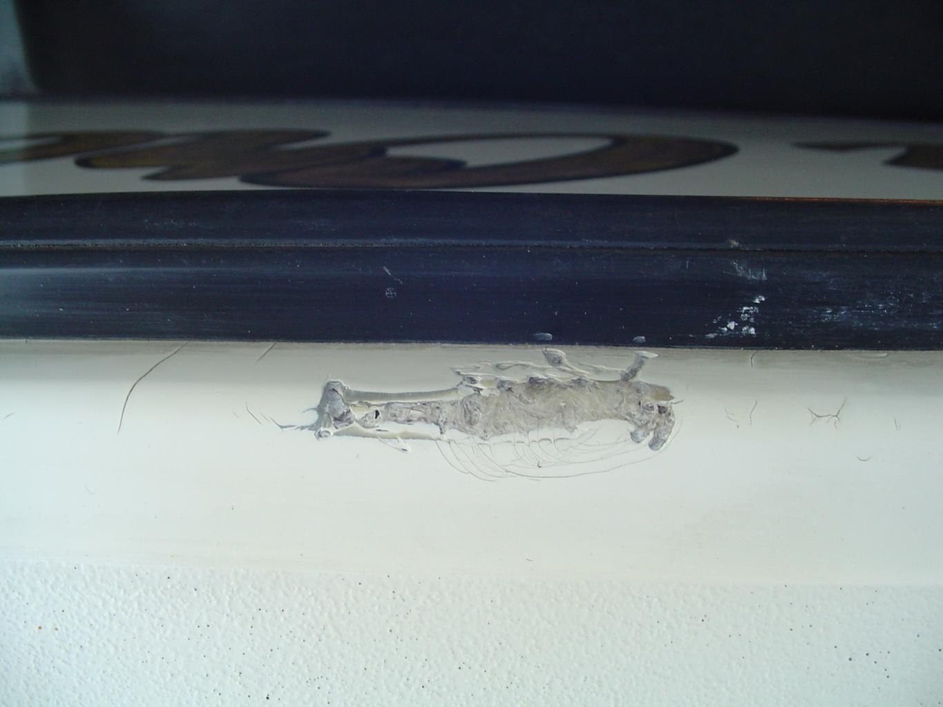

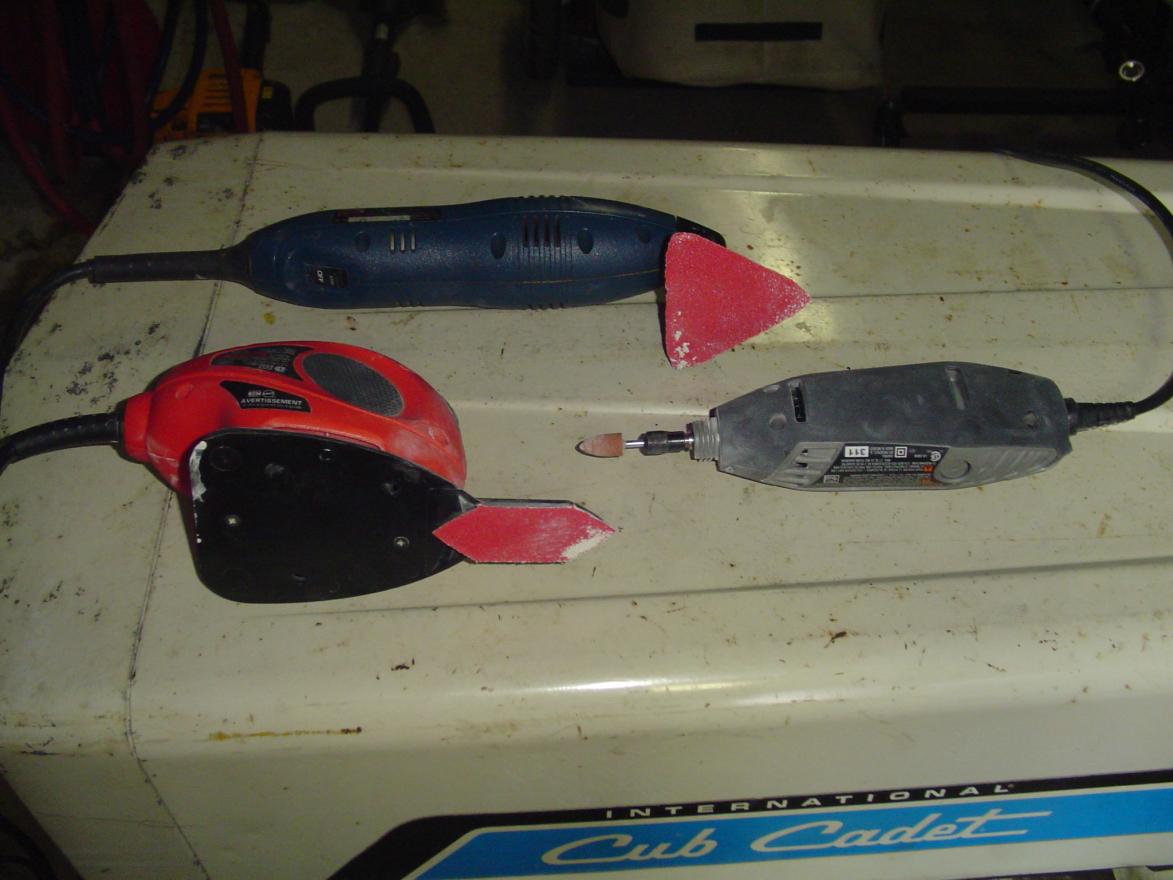

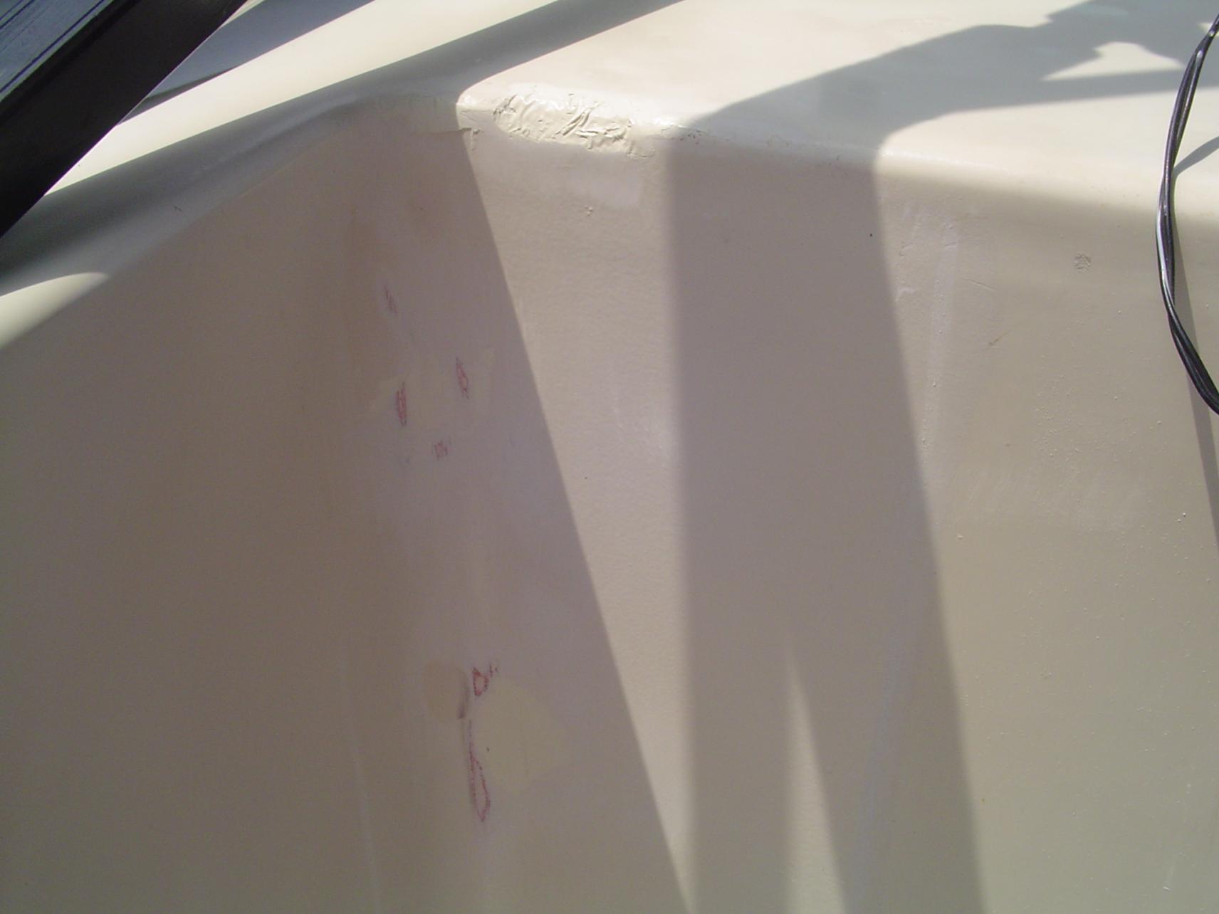

I have started gelcoat repairs on SeaCracker and am having issues. i started by opening the cracks with a church key, but that wasn't working out. I went to a dremel with various shaped stones and am taking the cracks & nicks down to fiberglass. I'm using Evercoat Marine match & patch. My issues are: pin holes in the gelcoat after sanding with 220 grit. I assume I'll have to add anothe layer and repeat the sanding process? I have several areas where I'l sanded thru to the fiberglass upon sandind with the 220 grit? I'm not so much worried about the color as I know a really good match will come with continued repairs. 1st batch was a little to reddish, second batch was closer. My sandpaper ranges from 80 to 800 grit & I'm using rubbing compound & Mother's carnauba wax. I tried several marine waxes, but Mother's has the best shine.
Old 07-16-2017, 07:46 AM
cdlong cdlong is offline
Join Date: Apr 2015
Posts: 80

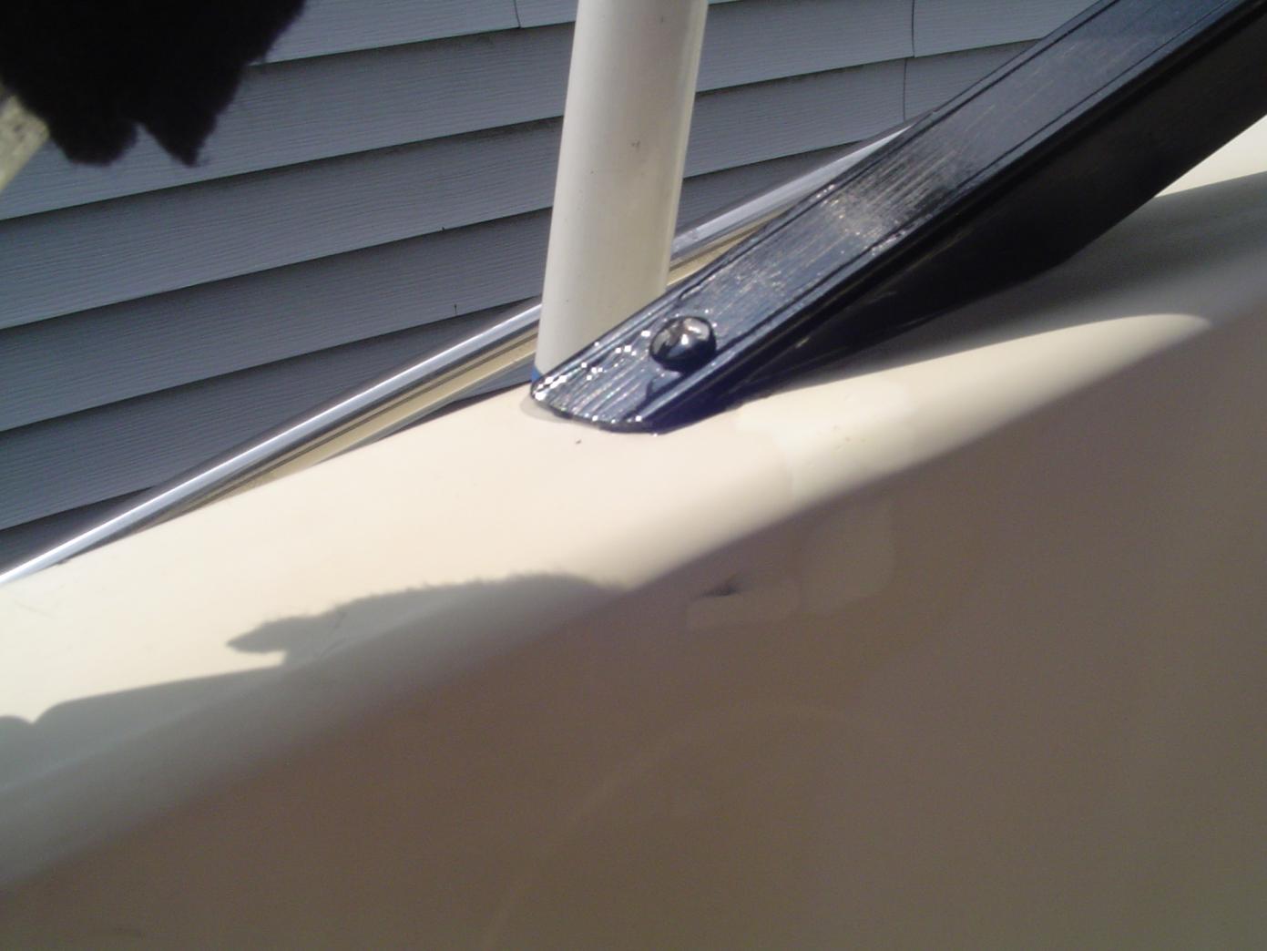

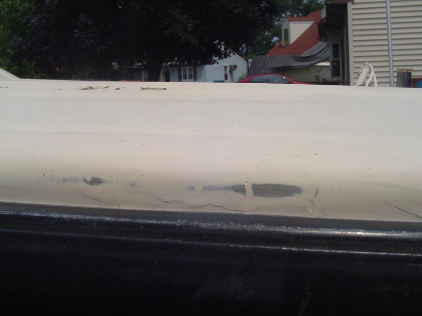

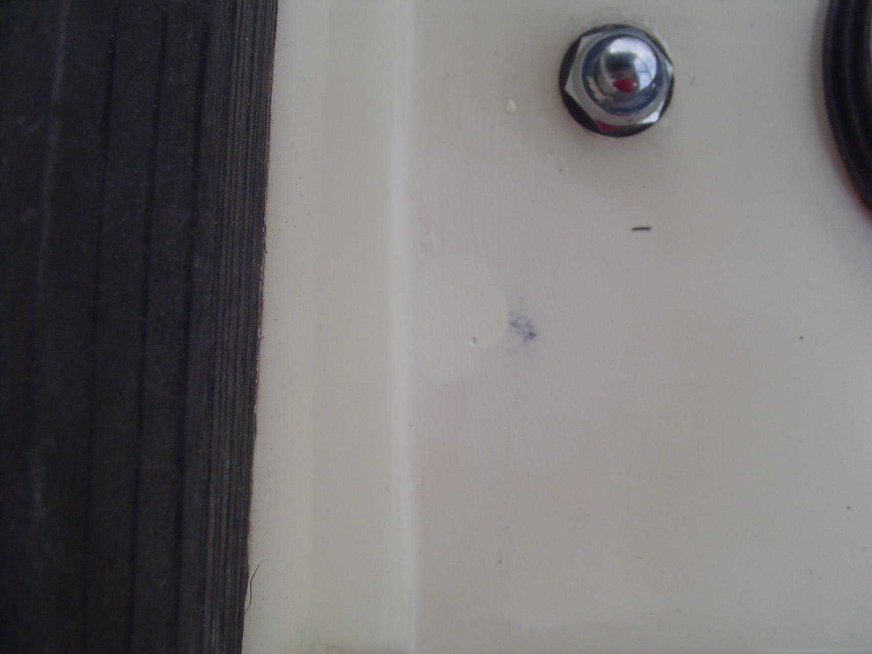

More pictures. I haven't finished opening up the last 2 pictures yet. Just giving you an idea of what I'm doing. Any advise, different tools, etc. will be greatly appreciated!

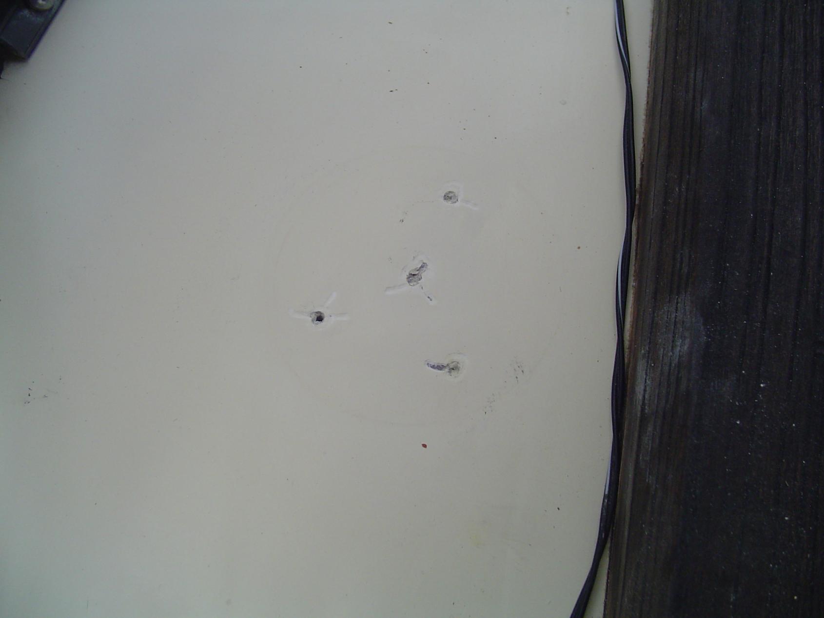

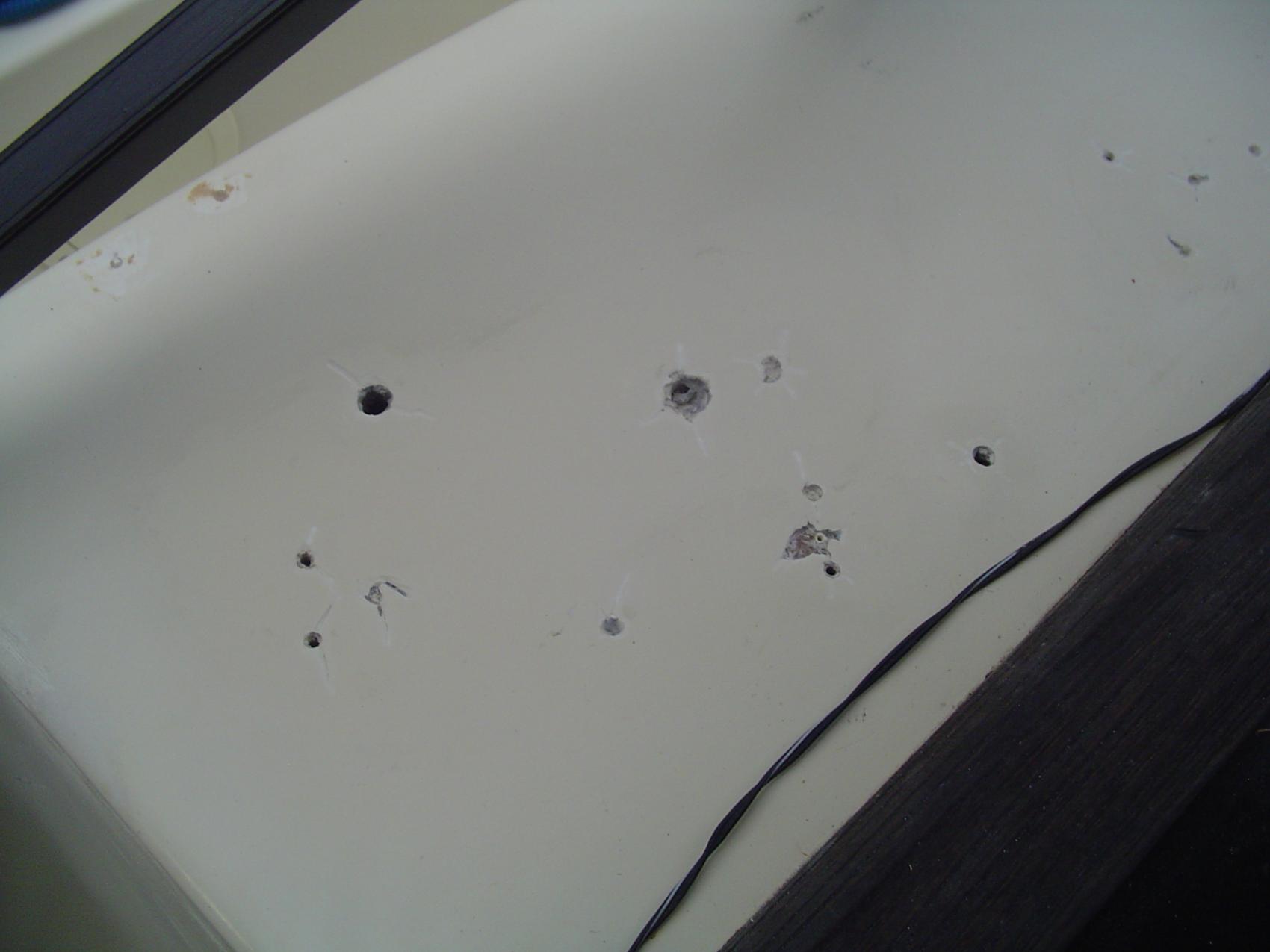

Update, It took 3 batches to get the color very close. Now I have to grind out all the previous repairs and redo them. Buy the large tubes of tint, they are much easier to get uniform drops from. I save the cardboard I mix the hardner into the gelcoat on to check the color. Only do one repair until you get the color right. I have purchased a palm polisher from Harbor Freight to compound, polish & wax the top sides of the cuddy. I also am using an electric palm sander for the 500 & 800 grit wet/ dry paper. Yes, I have a GFI, but I'm using a hand spray bottle. I use the Mouse & triangle sanders dry, then wet sand by hand with 220 or 320 depending how thick I put the gelcoat on, I realy like the Evercoat gelcoat, it doesn't run. There were 3 holes in the last picture which was the 3rd batch of gelcoat. They need need a cover, (thin) coat, then final sanding using 500 wet/dry, then 800. Fololowed by the rubbing & polishing compounds, then wax.

Found a guy in VA Beach. He told me the "burn thru" is actually the primer that was applied to the fiberglass before the gelcoat was shot. Dark primer helped show the coverage depth of the gelcoat while it was being applied.
My son, the painter, said Dad toss the plastic spreaders and get some flex puddy knives. I got a 1 1/2 & 3 inch knife. Seems to be helping a lot getting the air out of the gelcoat. I'm going to try a foam brush to apply the gelcoat over the spots where the primer shows thru. If this doesn't work, I'll have some Rustoleum paint tinted and apply it with a foam brush, Then wet sand just enough to get it smooth.
