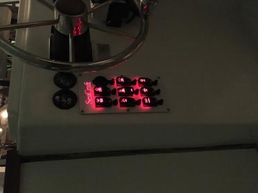

For those of you guys looking for a new custom switch panel you should try out new wire Marine in South Carolina. I could not be more happy with the results of my custom panel.

I had a panel made from them came out perfect very thrilled with their products and customer service!!! Highly recommended.
Your panel looks great..
