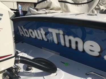

Isn’t it amazing what you can accomplish in only a few minutes! Lol all you have to do is blink and all the work is done. Kidding aside great start on the gunnels
Good time to decide if you want to change your anchor access
Did you built the hatch or buy it made. Is that a spot on the front to run anchor line thru. Also do get any mold . Looks nice
Any problems with banging up the paint/gelcoat when in a rush?And is it strong enough for stepping on?
Did it myself ,yes the notch in front is for the anchor line -allows the hatch to be shut withe anchor line out have not noted any issue with standing on it.sectioned the a hatch cover (I picked up )by taking a side grider and cutting the back every 3/4” to allow it to bend then recorded it with foam to follow the natural radius
Pretty work. Just finished grinding all the old core out of cap going to quit and watch some football. I think I may put vent up on bulkhead were cap hangs over so it ca breath a little in there. I see u are n lauderdale not far from u down n Boca
Not far at all hope your projects goes quicker than mine
