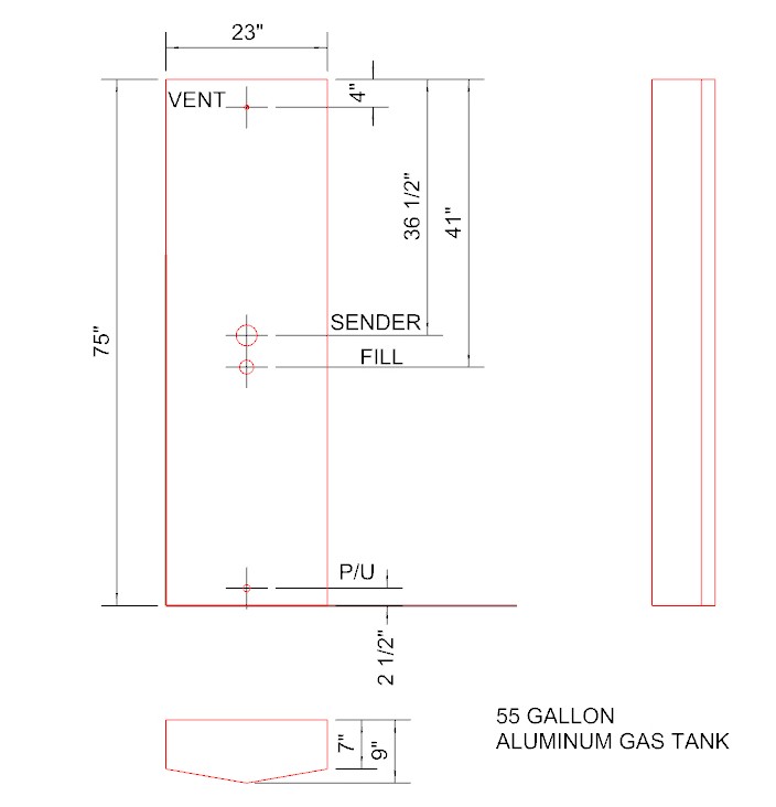

Old 05-15-2019, 04:06 PM
IslandMarineGroup IslandMarineGroup is offline
Join Date: Oct 2017
Posts: 16
Sketch of the fuel tank.
