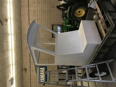

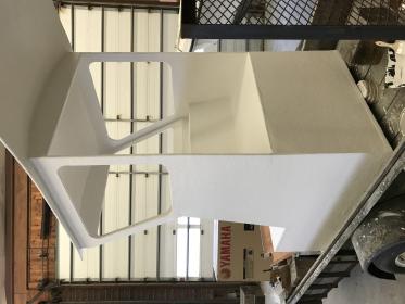

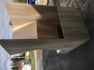

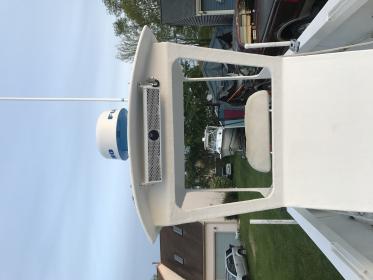

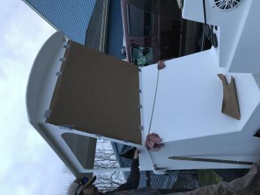

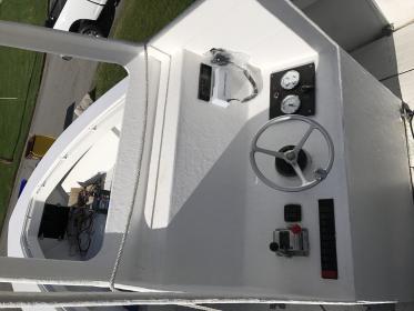

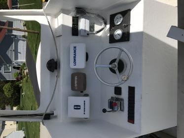

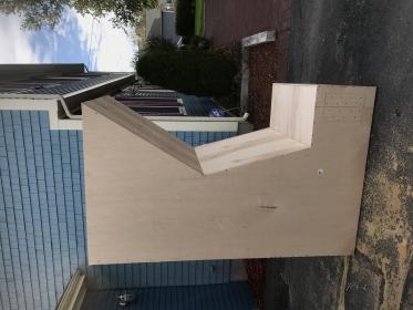

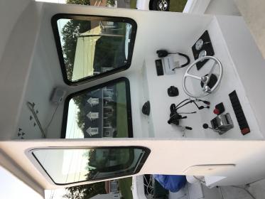

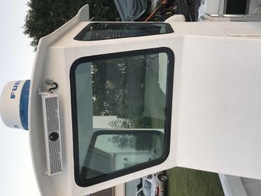

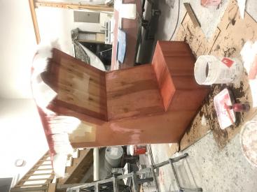

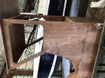

This is an after post to help people out on an idea of the way I did my doghouse build from scratch. It’s large due to having to fit over an inboard motor, the base footprint is the same dimensions of the console I took off the boat. Happy to answer any questions. It was a fun project that ended up being worth it.
A few main things.
All stainless steer fasteners were used.
All window cut outs were wrapped in Fiberglass.
Every single hole drilled was sealed with 5200.
The windows are wynne industries clamp in aluminum frame
And the bottom edges that are in contact with the deck have a triple layer of Fiberglass to prevent wearing through
