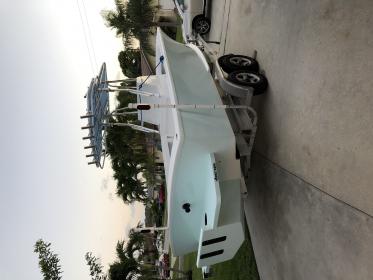

i have a smaller console 34" wide x 52" long on my 23' and the front of my console is 30" from the forward casting deck. I wanted it as far forward as possible without looking strange. 120 lbs of batteries mounted all the way forward in my console under the seat. i test drove the boat for the first time this week and with a suzuki DF350 on a hermco twin bracket, the boat is very well balanced. does not squat. i can get a picture tonight.

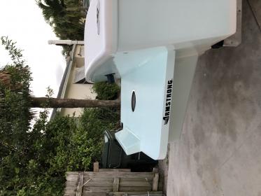

Looking forward to pics. Are u the first person to do a 350? I remove my casting deck and have the console about 40 inch back from the bulkhead were step started about same place were u measure from which I believe at 40 inch is close to original location and it feels good and plenty of room between console and leaning postlwell and and between leaning post and transom crown. I did move tank forward and will have 2 both battery’s forward in consol. I have a twin Armstrong set up for 30 inch shaft so it sits about 3 inch from keel suppose to have great flotation. You have given something to think about now. I do like 2 fish 2 kits so was hoping to still have good deck space up front plus a coffin box.
Thx for your return was thinking no one liked me. Lol
Old 05-30-2019, 12:02 PM
Oldboat Oldboat is offline
Join Date: Jan 2017
Posts: 206
Here two pics not great and nothing is bolted down

One last thing my console is 48 deep without a seat again there will be an 80 lb coffin box up front without fish or ice. im Thinking with my console being 4 inch forward in the back moving operator forward a little and the coffin box if that works to balance out the 10 inch difference in placement. Got to get this right, any thoughts

Man that thing is beautiful. Really like the spray rails.

picture attached.

blurry picture, but here is the first time floating.
