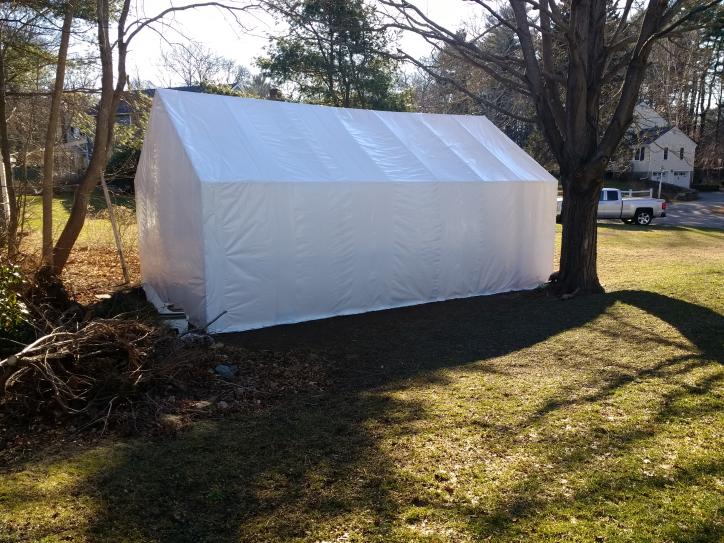

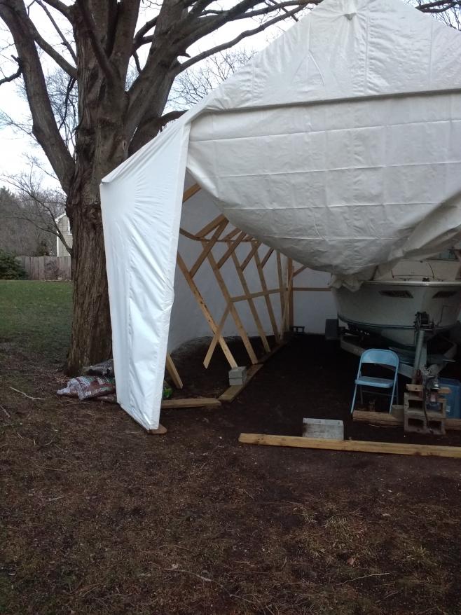

Just when I think I am ready to get to work with the boat shed being all ready I get this.

South Shore of Massachusetts. Went out for a dentist appointment and it was raining and 37 degrees. Got home and it was getting sunny and 50 and a little breezy. All was good with the shed. Then the wind. At 5:00 we got the 50 mph gusts and the shed got blown out. I secured it with ratchet straps. It is holding on now. Tomorrow will be getting back in shape and screwing everywhere there are nails. Also I will be adding ground anchors and maybe some more bracing. Only a few holes in the shrinkwrap to patch. The gut punch is subsiding now that I have a plan to repair it.

Get your self a bag of Simpson straps at Home Depot...
Also on the rear of the structure tie in a 2 X 4 from the inside corner at top
than angle to center at bottom, from both sides.

Lots of progress today. She is back in position after the whole thing shifted a little. Took ratchet straps connected to a tree to move it. I got a bunch of the hurricane straps for the roof to wall joint and then right angle braces for the wall to base. Lots of 3" screws additionally in each joint.
I was looking for heavy duty screw in ground anchors, but all Home Depot had were the dog runner things. 3 out of 4 corners have the anchors screwed in the ground with a piece of rebar wedged over the PT frame. The 4th broke when I was screwing it in. A more substantial option will be needed.
Tomorrow will be finishing up a few more of the braces and then screwing in 2x4's diagonally on each wall panel and the corners. There a few tears in the shrinkwrap that will get patched. I don't have the propane heat gun, just a regular one. It works, just slowly. I will need to retack the shrinkwrap all around the base too.
The final step will be getting the tarp door squared away. One 2x6x96 board wasn't enough to keep it weighed down. I am thinking screwing 2x4's to the PT and to the frame and adding ground anchors may work. The taped in zipper door survived and will be my entrance/exit. More pics to come when she is back in shape.
