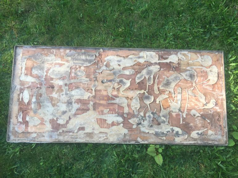

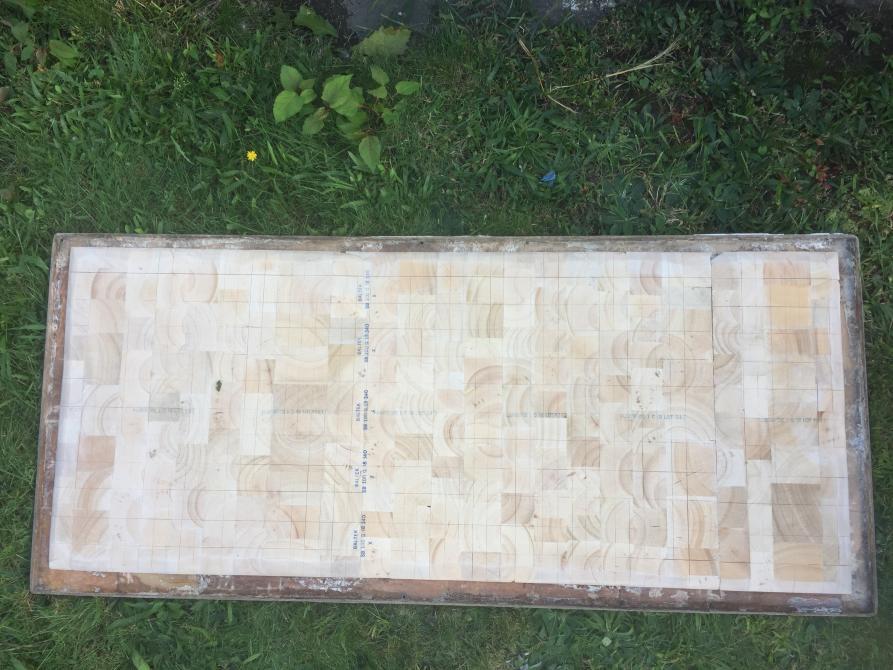

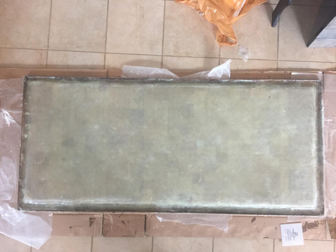

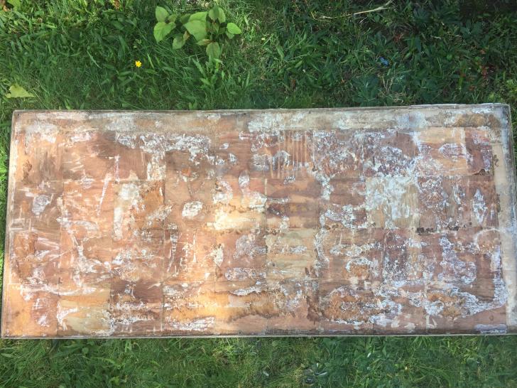

Hey everyone, I finally got serious about working on getting this old girl seaworthy. With the time off available from the current situation, it lends to an agreeable solution between me and the wife. Convincing her that the boat would be a great way to socially distance ourselves wasn't too difficult. So I did the gas tank hatch repair last fall but just got around to posting the pictures. When I bought the boat, the previous owner told me the hatch needed work and used plywood and liquid nails for a somewhat temporary fix. I fully realized this when I was moving the hatch for the first time. The fiberglass was completely separated from the hatch core. I bought some 1708, balsa core, and West System epoxy to start the repair. I used a heat gun to remove the old glue and balsa. Once that was cleaned, I measured the balsa for a solid fit then I sanded the edges down to a less aggressive edge. I mixed some epoxy then laid the balsa core on it. I should have mixed a filler material in with that epoxy but hindsight is 20/20. I laid it down and added weight to ensure it set. After that, I laid the 1708 and epoxy. Other than the epoxy leaking out through the screw holes, it came out pretty good.

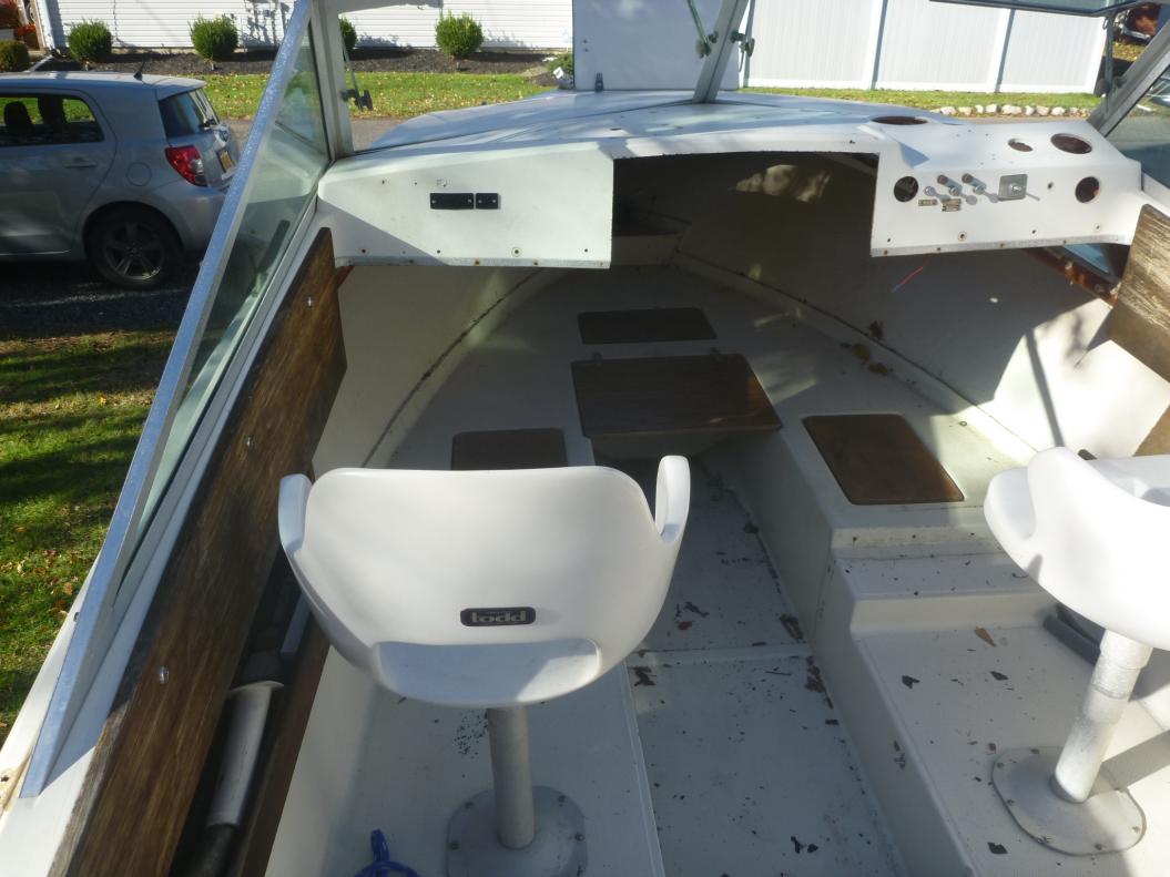

I pulled the old switch panel and steering wheel off to clean up the backside of the bulkhead. I found some soft wood around the switch panel and started digging... I pulled the trim for the door off and the wood was soaked. Time to add to the list! I took the fiberglass off on the cabin side and cleaned up the old, rotten wood. The other side needs to be done as well. Both sides of the bulkhead had this hard red putty along the bottom and up the sides attaching it to the rest of the boat along with screws. Is it like a bondo type material?

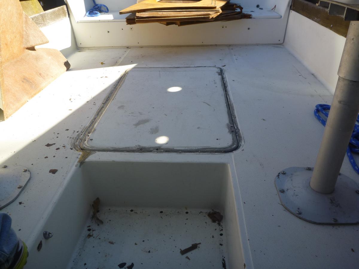

The step down is very soft too so I'll tackle that soon. My plan is to use the dremel to cut the skin off then dig out the crap wood and lay in the other balsa core I have from the fuel tank hatch project.

My best tool for getting that plywood off was a grinder with a sanding disc attachment. I used this and got some really heavy duty sand paper. I’d recommend templating before you get too far into demo. That could have saved me lots and lots of time and materials.
https://www.homedepot.com/p/DIABLO-4...S01G/202830887
That red stuff is potter putty. Essentially peanut butter fiberglass. Teak looks really good. Mine was in far worse shape. Yours should look even better. That Pettit flagship varnish is thick enough to cover the grain and level it out with numerous coats applied. You must seal the wood first or it will crack on you. Shellac makes a good sealer. You can buy many brands of sealers too. But the dirty secret is most of them are alcohol based (just like shellac).

I finished the bulkheads and installed the new switch panel and fuse block on it. I decided to go at the transom from the back. That is now cut and all of the old, rotten plywood is removed. In addition, I started on the stepdown area since that was very bouncy. I made a slight mistake in cutting through the bottom fiberglass so the entire thing came out. How would you go about putting the floor back in? I was thinking of creating a few braces to install on the bottom and epoxy them at the proper height so the floor goes back in at the right level.
Old 05-22-2020, 12:44 AM
Join Date: Oct 2016
Posts: 320
I’d put cross braces (2?) and vertical supports. 3-4 per side. Definitely below the cross braces.
