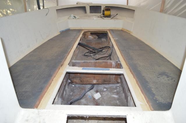

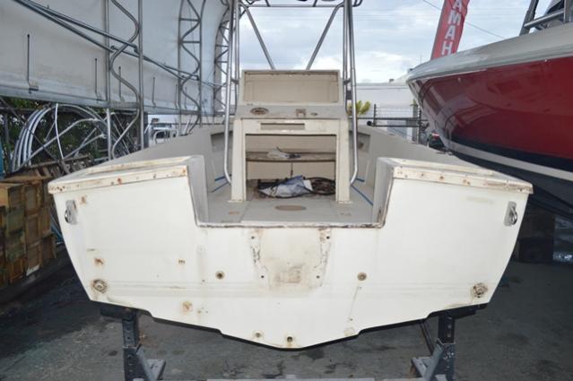

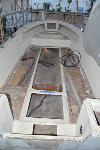

OK, so not really a Classic, but this gentleman had us redo his 1985, keeping it all original with a couple of updates.
- Fill in the transom, add a custom transom livewell and a Hermco bracket.
- New deck, with Coosa Board, remove in deck livewell.
- Redo the console and electronics cabinet.
- New wiring.
- New fuel tank.
- New electronics, Garmin, Fusion and Wet Sounds.
- New LED Lighting.
- Paint the engine, new graphics.
- New Rocket trailer.

So, where were we. Fuel tank test bad. Out she comes.
Start doing the custom transom livewell.
